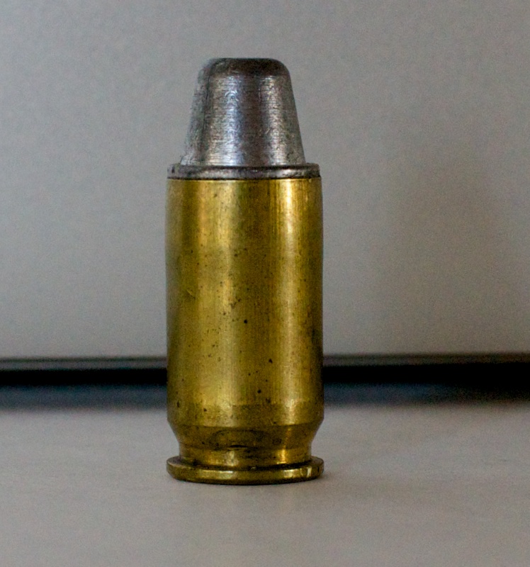

Bullet 200 gr SWC linotipo 75% 25% lead (actual weight 195gr)
Powder: Vectan BA 10 - 3.3 gr
Sizin & LUBE 452 "
Mold LEE double cav. SWC 452 "
Between centers: 18mm wide and 14mm high

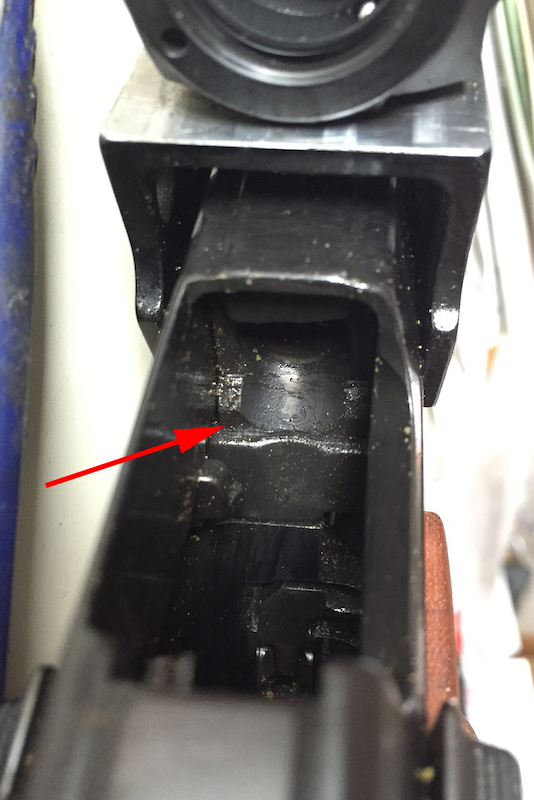

I am very frustrated after reading the above posts. I have a 6" GT45, but mine will only shoot round nose bullets and (fortunately) the 185 gr. Zero JHP bullet--NOT lead HPSWC or any other lead SWC bullet for that matter, including the stubby 185gr Missouri bullets. The problem is that the tip of all of the LSWCs sticks on the step-up gap that exists between the feed ramp on the "trigger housing frame" and the ramp for the barrel (see illustration).
Do your GT45s have a similar 'gap?'
This gap is not large, but it is where the nose of lead bullets stick (except for lead roundnose). I do not know why my pistol chokes on all my the few bullet configurations.
My accurate BE load is 185 gr. Zero JHP bullet, 4.6 gr VV N310 (long line) and 4.6 gr Bullseye (timed fire), federal primer; shot with medium spring. I would love to get my pistol to shoot well with Zero 185 gr lead HPSWC bullets as I have several thousand. Stuck, dipnet
- GT45 barrel.pdf
- (99.96 KiB) Downloaded 395 times

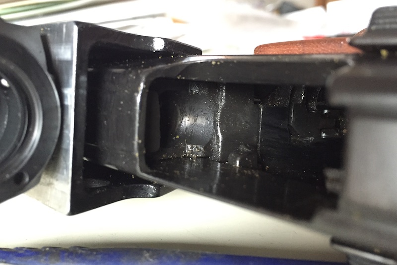

Here's a photo of that area on my GT45 (slide locked back, obviously.) I haven't cleaned the gun since the last match, so sorry about the crud.Dipnet wrote:Do your GT45s have a similar 'gap?'
Re: Load data for Pardini 6" GT-45
Bking,
Thanks for the image. Yes, the gap I was referring to is indicated by the red arrow inserted into the image you sent. Where the arrow points to is where the nose of LSWC stick, causing a failure to feed.
After looking at your picture, maybe I'm cleaning my gun too much ;). Then again, it could be a magazine lip issue. Since my chamber looks exactly like yours, maybe I need to load some dummy rounds and carefully study how bullet is pushed off the slide and how it is chambered. Since some shooters can shoot LSWC well with their GT45, there must be a little tweaking that will resolve my problem. Best, dipnet
