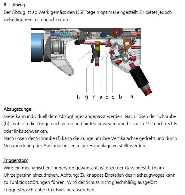

I just got my new LP400 (cilynder date 10/2014, so I assume the gun is from the same date). I assume it comes with the "latest setup " springs!
Adjusting the trigger was a pain in the ass! The second stage was so heavy, so I removed the 2nd stage spring to check if it was the cause of the problem!
So I found out that the poroblem is the sear engagement! go get a lighter second stage, instead of the normal 1/4 to 1/2 anti-clockwise turn (like the procedure described on LP300 manuals and other APs), I had to adjust it for 1/12 of a turn ( yes, just a turn 30º )! I taped on the gun, on various positions to ensure the trigger was firing without pressing it!
The second stage screw is unscreed all the way, so I used a bit of locktite to to ensure it doesn't come out... I can always cut a bit of the spring!
Now, the trigger feels good for me! Very crisp, but also with light second stage!
My conslusion is that, regardless the springs (that you can adjust), the sear angle was conceived for a very crisp trigger! I guess with time it will polish a little and I will have to re-adjust it!
The factory trigger setting are ridiculous, very long and light 1st stage, a a brick wall on 2nd stage. No wonder why people complain so much ... (most of the shooter I now are afraid of deep tweaking their guns)!
Re: Trigger of Walther LP400
If you do a search you will find the trigger has been discussed a number of times.
The second stage was a balance between two springs (one adjustable). These opposing
springs set up a feel so that little or no trigger collapse was felt on sear release.
The problem with the original trigger was the inability to reduce the second stage weight
down to very low values.
Some coaches would say insane weights on second stage.
What happened was that the second stage spring was fairly stiff but with limited range, so
you reduced the spring contact to reduce weight and the spring would loose any contact
(ie no compression) this made the sear unreliable and total weight variable.
The update was to remove the paper clip spring and change the second stage spring.
This gave a lighter second stage weight but in my opinion it also changed the let off feel.
My solution was to keep the paper clip spring opposing the second stage spring to keep the feel
and to change the second stage spring to a lighter coil weight but with increased length.
This gave me a lighter second stage weight and increased the adjustment range to keep a
linear adjustment on the sear.
My trigger has a nice feel with a reliable 400/120g weight.

Mine is also very crisp now. Second stage weight is finely adjustable with whole turns of the screw I made from acetal, coupled with very light but long spring. Pictures aren't very clear but show what I've done. Also is a picture of rear sight elevation adjustment knob.
