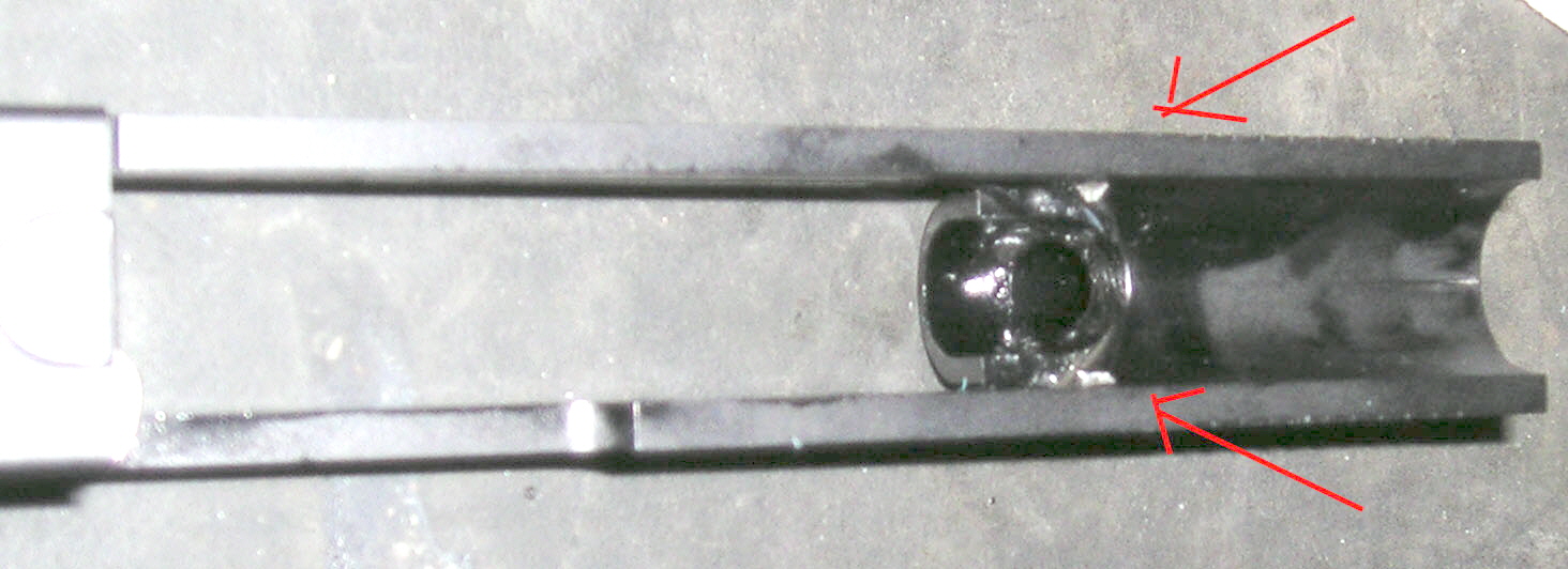

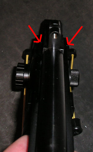

There's no binding of the slide to the frame. The 2 ears of the square part of the barrel hit the inner part where the recoil spring goes in the slide and where that part of the barrel also goes into it. The aluminum is mashed down where they make contact, enough where the barrel is jammed into it. The slide goes back too far just as if the recoil spring is too weak.
With the Unit 1 off the frame and spring removed from the unit, I can move the slide as far back as it will go until the ears touch the inside of the slide. The barrel will stick to the frame. I don't think the slide should go back that far when shooting. The only thing I can figure would be a weak recoil spring. Maybe they shipped mine with a lighter spring or maybe my mainspring is lighter than the 19 lbs they say is ok at a minimum. Maybe the didn't machine enough metal out of the slide for the barrel ears to hit it.
I ground down a Shok Buf and put it in the slide and the unit doesn't stick just operating it by hand. Still don't think it's good for it to be hitting the shok buf on a regular basis.

My slide has a very faint peening on both sides where the aluminum is snow plowed forward a couple thousands of an inch.
If this is truley where it is hanging up, then it needs to be machined a bit more for the slide to travel all the way.

Are you telling me Marvel Precision did a lousy job machining their slide and some metal may need to be removed?
If you're getting some peaning also, doesn't sound good on your slide.
Here's some pics:
double click on the slide pic for a larger view.
Is your metal farther back than my pic? Took a bunch of pics and inside of things don't show well.
I still don't think the slide should go back that far as it's almost 1/2" more than the slide stop catches on.

I would like to see a better close up pic of your slide, the pic you have is horrible.

C. Perkins wrote: I would like to see a better close up pic of your slide, the pic you have is horrible.
Pics didn't come out well as it's hard to get it to focus on the inside part, not the top. Took that thing apart so many times today, I'll have to get in the mood again to get more pics. Pics were mainly to show where the problem is as many had posted of binding problems with the frame.
