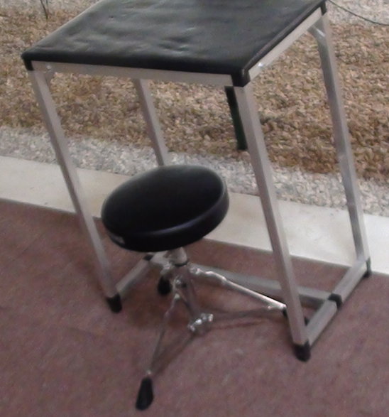

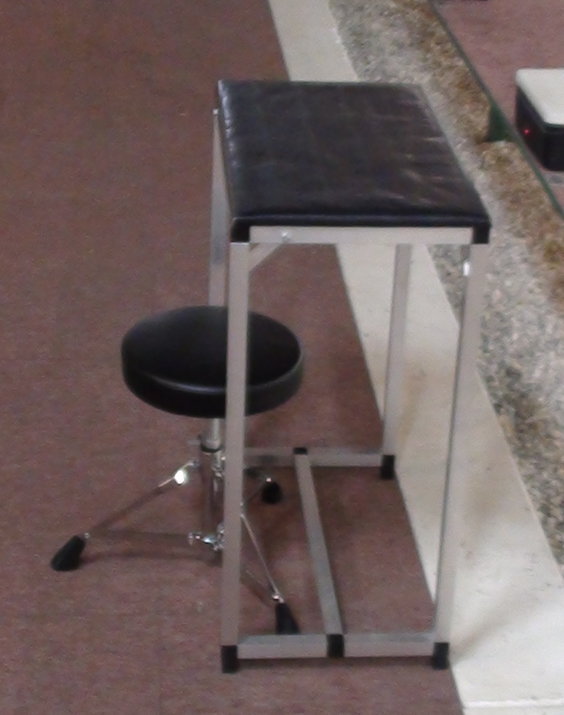

legless78
Posts: 4
Joined: Tue Feb 21, 2012 6:23 am
Post by legless78 »
Hi Guys
sorry have been away for so long.
my table project came up a treat and have fired from it a few times now.
total cost table and stool $50
Will Hart
Posts: 40
Joined: Thu Mar 03, 2011 2:05 pm
Table
Post by Will Hart »
Table looks good! Basic, sturdy, light, and cheap. Does it break down for traveling? Any chance of a photo of the underneath (table) framework?
Thanks for posting.
Will

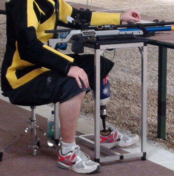

RossM
Posts: 89
Joined: Mon Sep 05, 2011 1:09 am
Location: Upper Hutt, New Zealand
Table for SH1
Post by RossM »
Check out the photos on the Benning World Cup. Photo 292 and 299. Greg Reid from New Zealand on the right in 292. I built this table. The legs screw onto bolts through the table. The front legs of the table telescope over the back legs of the table (saves space). Likewise for the chair legs. I have thin plywood boards that connect the legs of the chair to the back legs of the table (see 299). These have a wooden peg that fits up the leg of the table and legs of the chair to give stability. the chair is clamped to the back legs of the table with velcro for extra stability. It is a very stable setup. samll plywood leg stands fit in the front legs of the table.
Lifting the left or right leg of the chair after undoing the velcro allows the chair to be swung out so the shooter can get in and out quite easily.
I have asked Greg to photgraph the connections a bit more and I will post them. I designed it to fit inside a "standard" and available suitcase. One allen key and two pieces of velcro are the only extras.
