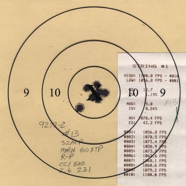

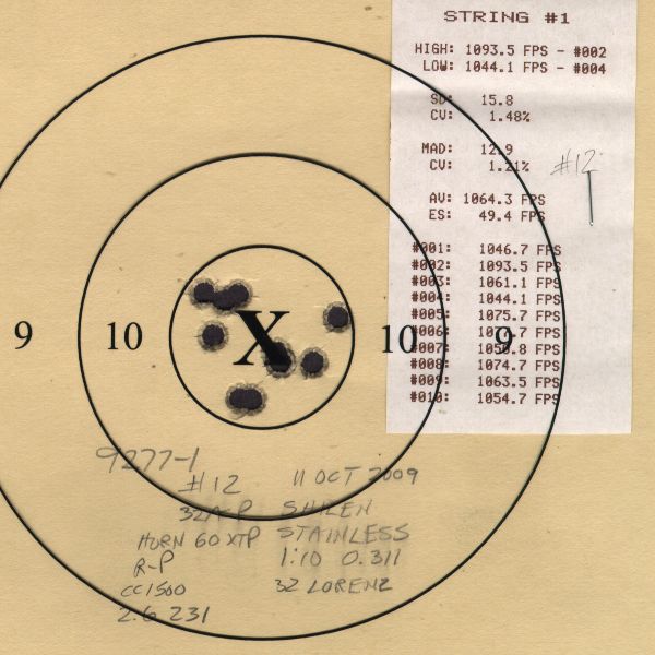

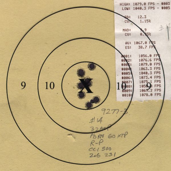

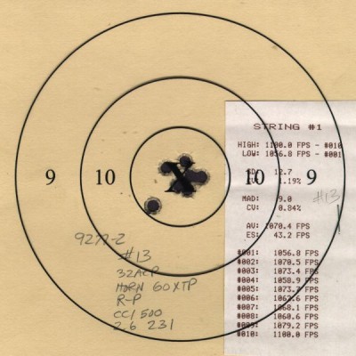

I machined a barrel for a fellow forum member in 2009. The barrel shot well; but, the user pointed out that it destroyed extractors and had given up on the project. The pistol was a Pardini HP with a custom Shilen Ten twist barrel.
Attached are the test targets I fired at 50 yards.
Before you ask, NO, I will not machine any 32 ACP barrels.
