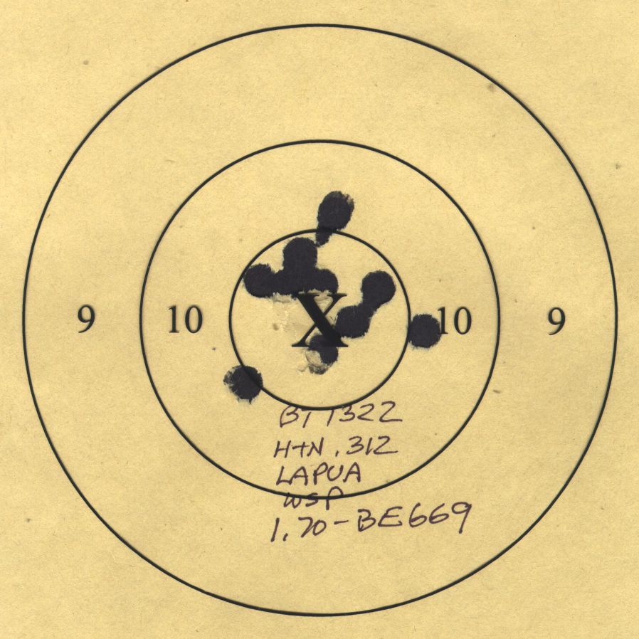

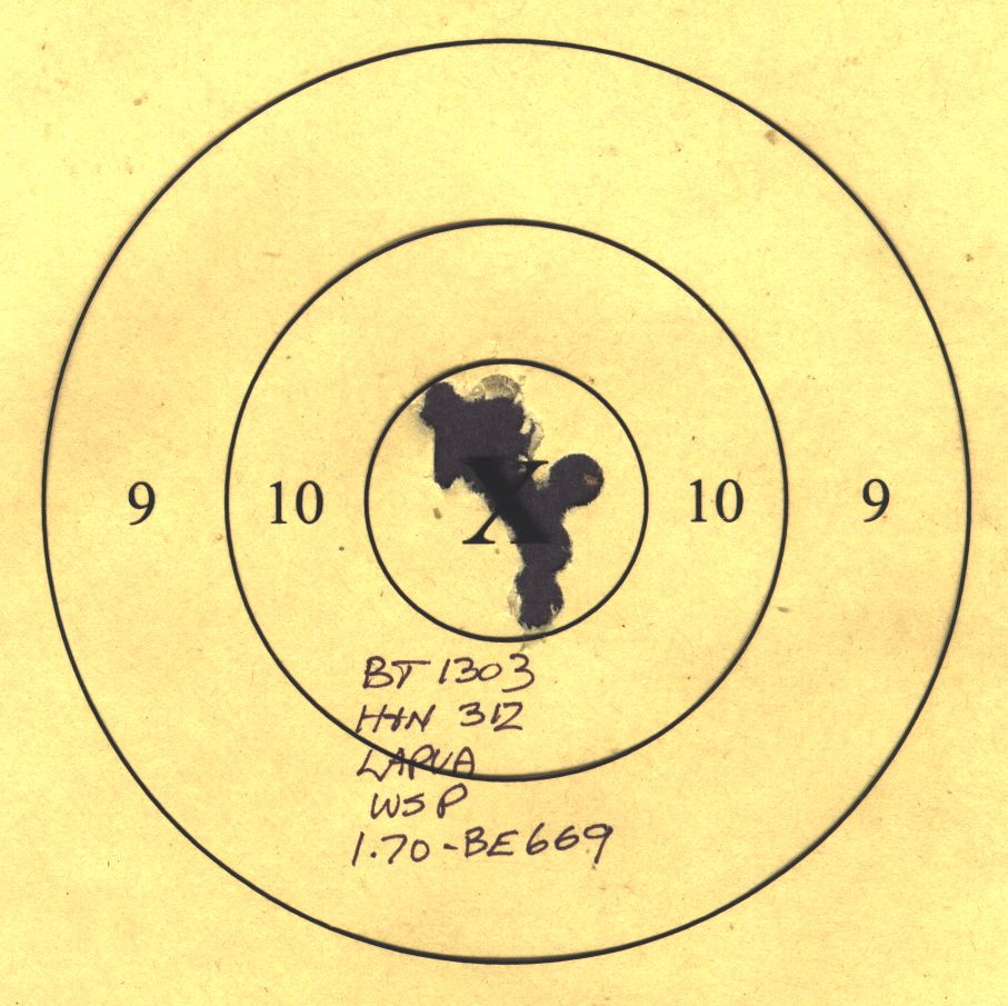

Just finished testing two barrels last weekend. Both seem to work okay with my taper crimp of 0.325". I must admit, loading the 32 is not as easy as the 45 ACP.
I do not care for the roll crimp as it works the case mouth too much leading to early cracks. Also, the taper crimp process is very forgiving of case length. Since 1994, I have yet to trim a 32 S&W Long case. Mine vary in length from 0.912" to 0.920".
With more experimentation I think you will find the determining factor to be the bullet.
Both barrels are for the Pardini HP. Material used is a Douglas Stainless 14 twist blank of 0.311" groove diameter.
Both targets fired at 50 yards.
