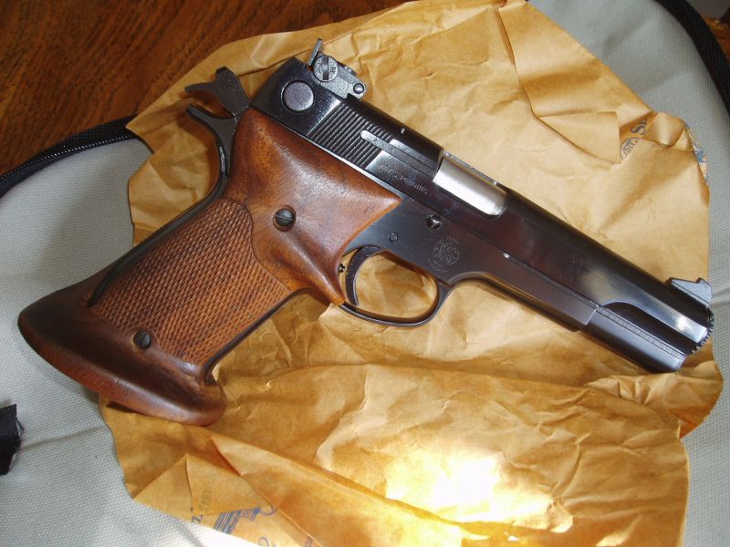

I am thinking about putting a red dot on my S&W 52-2. I am looking at the BME mounts. I have seen "Cal Grip" grip mount but don't know where to find one. Anyone have other recommendations for 52-2 mounts?

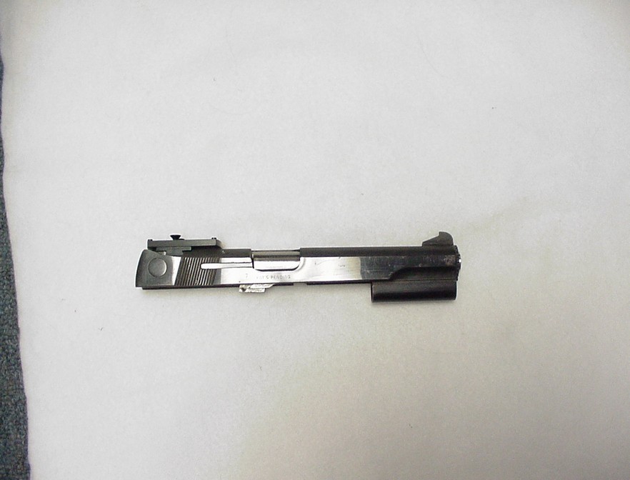

Howdy,
I have a BME frame mount. It is working well.
If you look behind the rear sight where the top of the slide meets the side of the slide (both sides) you will see a corner that I relieved ever so slightly.
This allows me to pull the safety and rear sight at cleaning time and remove the slide in a normal manner with out taking the mount off.
On my gun it was so little that a polish and Oxpho-Blue makes it undetectable and saves me from having to sight back in after cleaning.
If I get caught up later I will try to add pictures.
Mike
You can see the area behind the sight blade that need relieved. Not for the collector but not a bad mod for the shooter grade gun.
Good luck
Mike

Great posts and info, I have considered the Docter and it's rear sight mount. I just haven't seen many using that, any comments on how it's woiring??? That is a sharp looking 52 with the Nill's Mike (mstuhr)... It's good t o know that the slide can be removed with removing the BME mount every time cleaning is required...

danoinmn,
May I ask what grips you have on yours at the top of the page?

Post by danoinmn »
the grips on mine are vintage Herret's with the large thumb rest. nice grips for what i paid. i really like the Rink's and Nill's but haven't popped for those yet...
