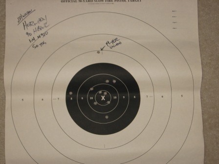

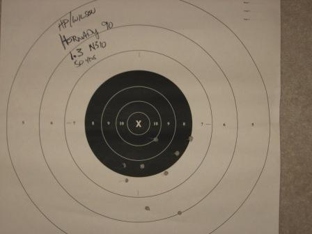

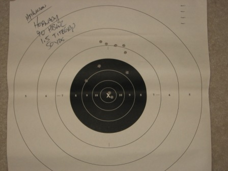

Hornady 90gr WC
Dave,
I did test the Hornady 90gr HBWC while building up the recipe for your barrel. (As you know, the eventual winner was the .312 H&N bullet with 1.3gr of N310 which produces consistent 2" groups.)
I tried 3 or 4 different powders and numerous tweaks without much success. Attached are the 3 targets using VV N310 powder which are typical of all the combinations I tried. In addition, I found the white powdery lube they use a pain to keep out of the reloading machine's internals.
