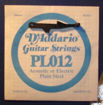

Paulo, I hope this helps you.
It's as simple as this.
No explanation is really necessary.
Just bend a guitar string into this shape and if it's too weak, you will know it by the slide locking back early.
If it's too strong, the slide might bounce out of the notch.
It's very easy to get it right, and when it's right, it will function 100%. Permanently. It won't wear out.
The reason it's missing, is because when it was being cleaned, it sprung out of the universe, never to be seen again.
Image[/img]

I believe that they changed the design a bit after serial # 20000, mine is a bit different but it will work fine, I am also using .30mm wire, and I see you used .38mm, it should be fine.
Its up and running, thank you very much for the help.
Update: After contacting FWB, they are sending me a spring free of charge. That certainly changes my first opinion about the reliability of the product.

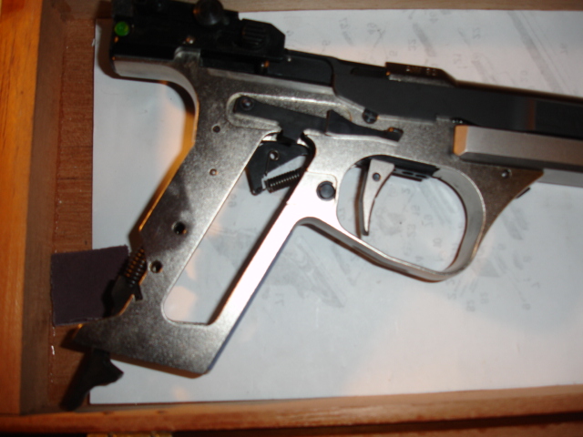

30mm string and slide stoper
slide and guitar string.jpg (40.37 KiB) Viewed 3299 times
Slide stop on the gun
