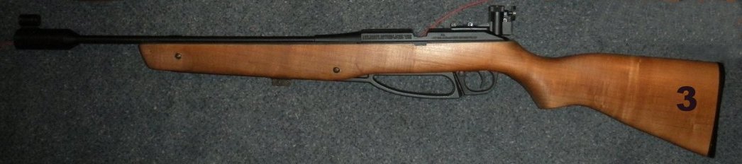

Used 853 Available
I have a nice shooting Daisy 853 for sale for $150 shipped to your door. Includes the gun and 3 stock spacers. Gene Jenkins n4jee@arrl.net
