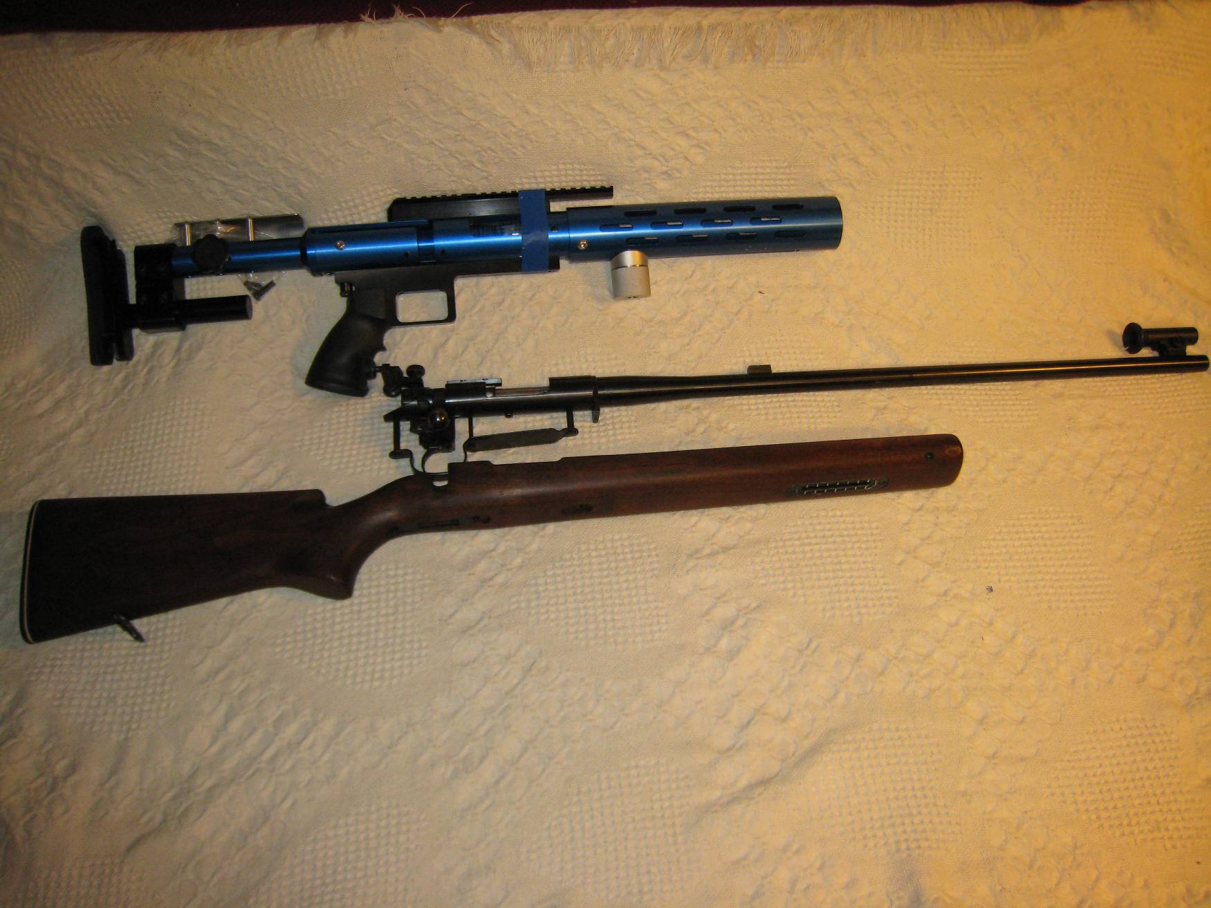

Post by GCSInc »
Phase one... Hope to get thru Phase two this week. Phase three is the range
40x Tube Gun
40x Tube Gun
an1913t
Posts: 42
Joined: Thu Mar 18, 2004 12:09 pm
Location: DFW
Post by an1913t »
Looks good - very promising. I'm definitely interested for junior shooters if the cost can be kept down.
Does the 40x receiver have to be epoxied into the tube or is it connected in some other fashion? I'm guessing you don't need epoxy as there aren't the recoil issues that you have with highpower tubeguns.
NateG
Posts: 28
Joined: Mon Jan 05, 2009 8:51 pm
Post by NateG »
Epoxy isn't required, even with a centerfire action. My R5 (the repeater on a Rem 700 action) in 6BRX uses a recoil disk, that replaces the normal recoil lug, to take most of the firing stresses. The action goes in the main tube and can either be epoxied or tightened in with some set-screws that the tube is drilled and tapped for.
It's my understanding that the AN-1 stock mounts by clamping (or gluing? I'm not sure) a sleeve to the barrel forward of the action. That tube then is what is attached to the rest of the stock, with the action floating.
