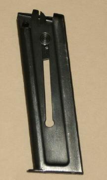

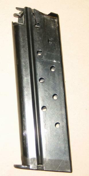

Trying to post pictures of various 38spl magazines. The first image is from Colt. It's marked Colt 38 spec on the bottom. The 2nd image is a modified 38 Super magazine, and the last image is an unknown mfg. Hopefully, the pictures are in the right order.
-s
-s
- this magainge is marked Colt 38spl on the bottom and I think from the factory
- 38spl_1.JPG (8.46 KiB) Viewed 15375 times
- Modified 38 Super magazine
- 38spl_4.jpg (22.46 KiB) Viewed 15375 times
- unknown mfg
- 38spl_3.JPG (5.12 KiB) Viewed 15375 times

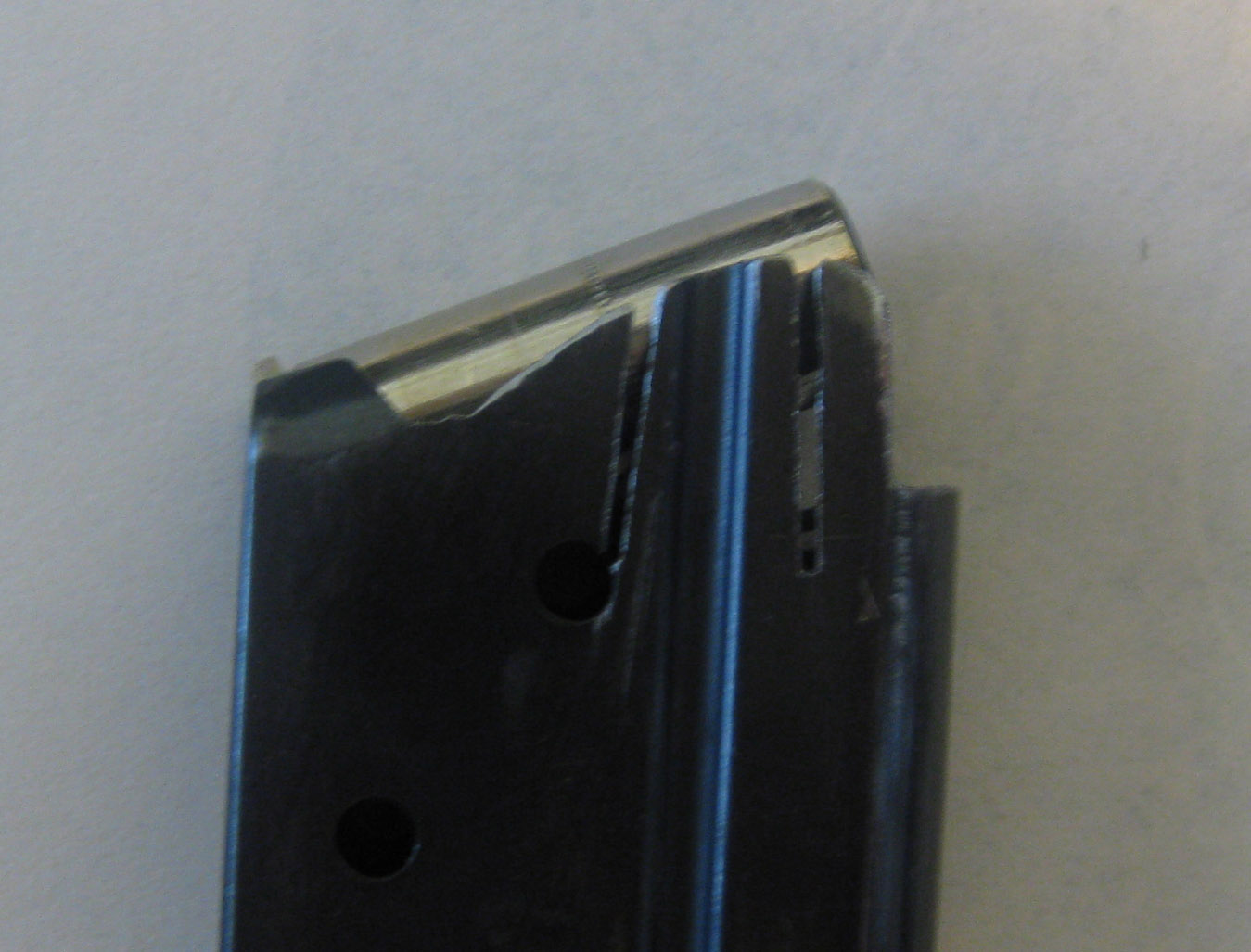

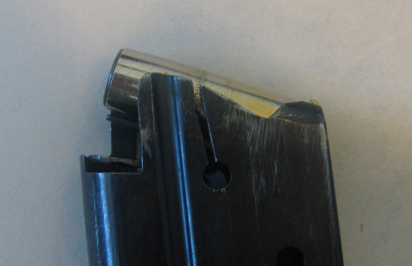

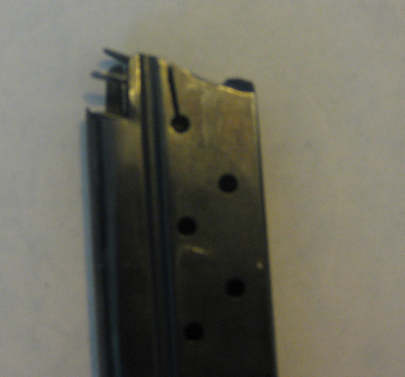

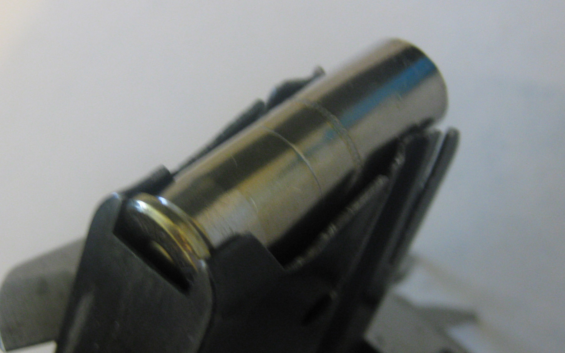

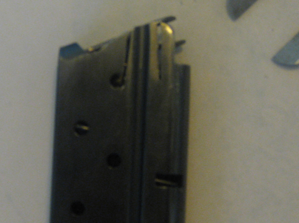

Yes, the areas you mention on the 38 Super that were modified. I assume the follower and the rest of the mag remain unaltered? Would it also be possible to show a round seated in the mag, from the rear, so I see how high it sits.
By the way, I think the unidentified mag in your pics is a Triple K 38 Special mag. They typically had a two-piece solid aluminium follower from what I understand.
Thanks, John
Thanks, John
Sorry for the delay. I meant to take pictures a few nights back but didn't get around to doing this until today. The attached pictures are of a modified Colt.38 Super Magazine. I think resize the pictures and cut the resolution in order to meet the website requirements.
If you PM me your private email address - I'll send you the full size pictures via email. Be aware the originalpictures range from 800K to 1.1Mb in size.
