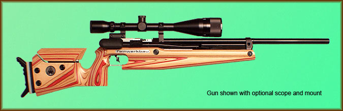

This shot of a 603 Jr. shows the scope anchored fore and aft. Do you know what's being used in front, then? Thanks for all the help, everyone.

Concerning the scope mounts, I saw some many years ago so my memory is a bit fuzzy. Those in the picture appear to be similar to the factory FWB mounts. The rear clamps to the sight dovetail. The front clamps to the rear barrel mount. In your picture, it looks like the rear clamps to the rear of the barrel.
