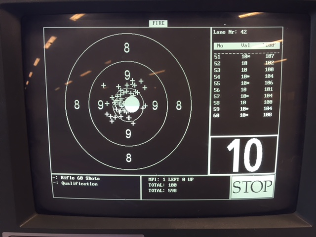

While I'm waiting for my starik tube to turn up I thought I'd experiment with adding wheel weights to my tube to bring it up to the same 220g total weight that Guy uses. I popped down to Bisley last night for a quick 60 shot match and the results............598/624.7 44x!!!! Absolutely smashed my old pb of 592 (and bisley pb of 585). So there would appear to be something to gain with weight at the end of the barrel!
The two nine's were the first shot after putting the rifle down for a break half way, and the second a 9.9 as the light levels fell. Looking forward to receiving guys tuner now.

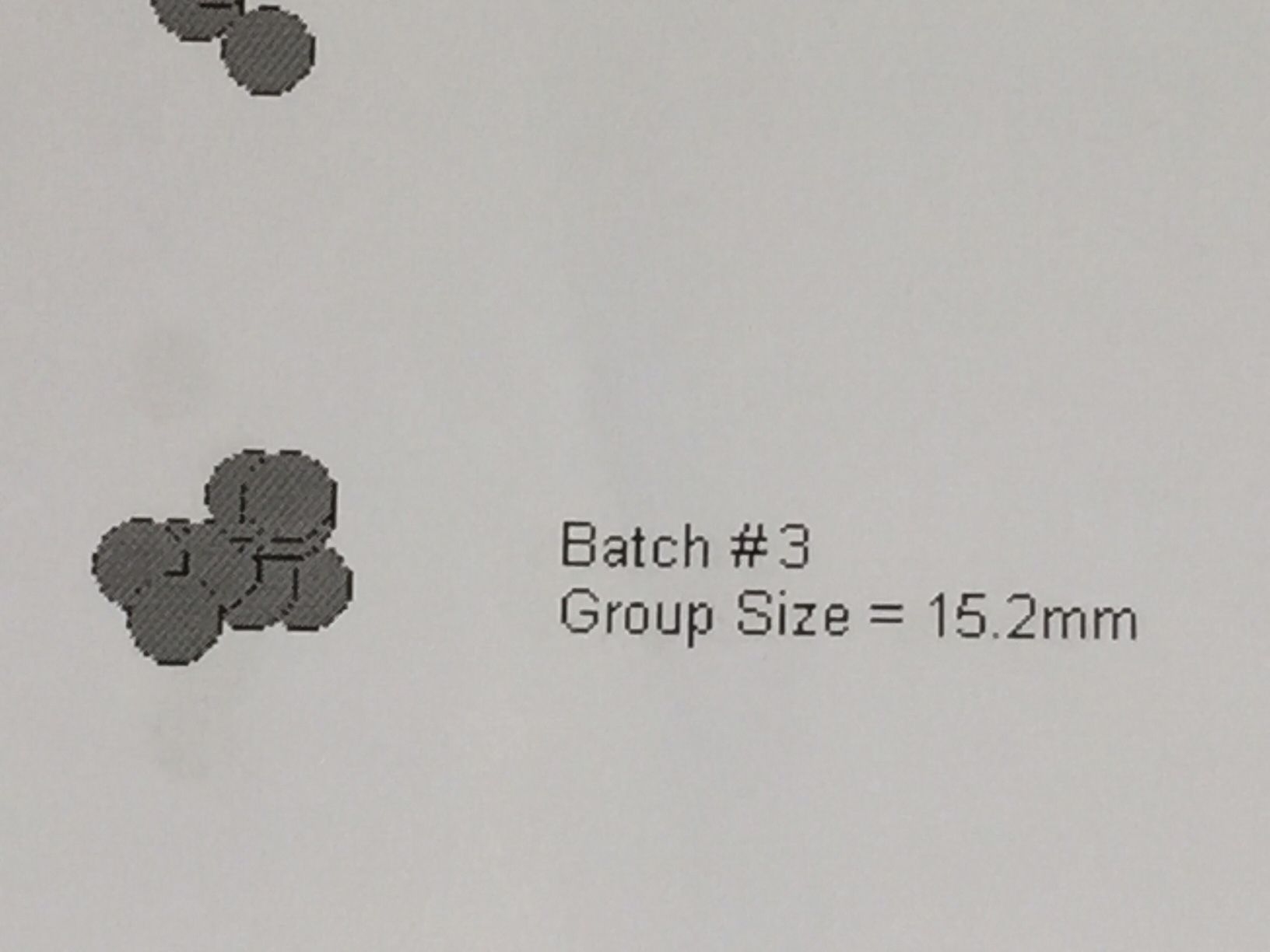

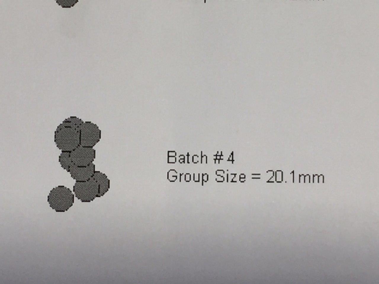

Just as an update, if anyone's interested.
Guy's tube has arrived and I've finally had chance to test it in a vice at Bisley.
I have two photos of the group size for 10 shots of Midas+ shot from a vice at 50m, without and with the turner.
So obviously there's a significant improvement with the tuner, this group was probably the best group size and the weight wasn't moved from the 0 position. I then wasted about 500 rds testing at different positions and things only really got worse, I didn't seem to find a few sweet spots that other people report. But I'll revisit again later, if I'm going to be competitive next year I'll need tighter groups than that!
Another point is that this same batch of Midas has tested better in the past, however that was when the barrel was new with less than a 1000rds through it and now it's upto about 4000 so has probably changed as its bedded in and isn't really 'matched' anymore.
Still work in progress but it would initially appear a worthwhile purchase.
