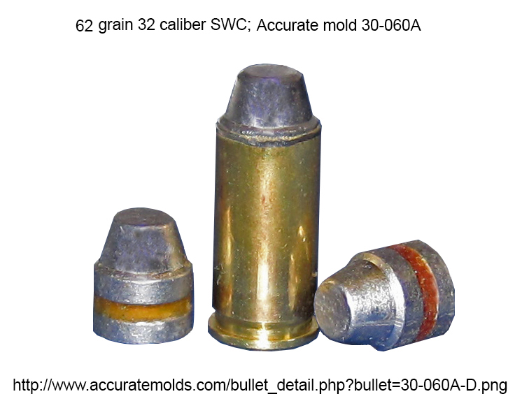

Alibi issue; 62-grain SWC bullet
Oldcaster is right; the alibi issue with the 32ACP seems put to bed. I shot a match yesterday using suggested remedies and no alibis (very commendable experience). Oldcaster's generosity with the bullet he designed is laudable. The 62-grain SWC bullet is well, cute and appears to be very accurate. It looks like I'm going to take up lead casting. Dipnet

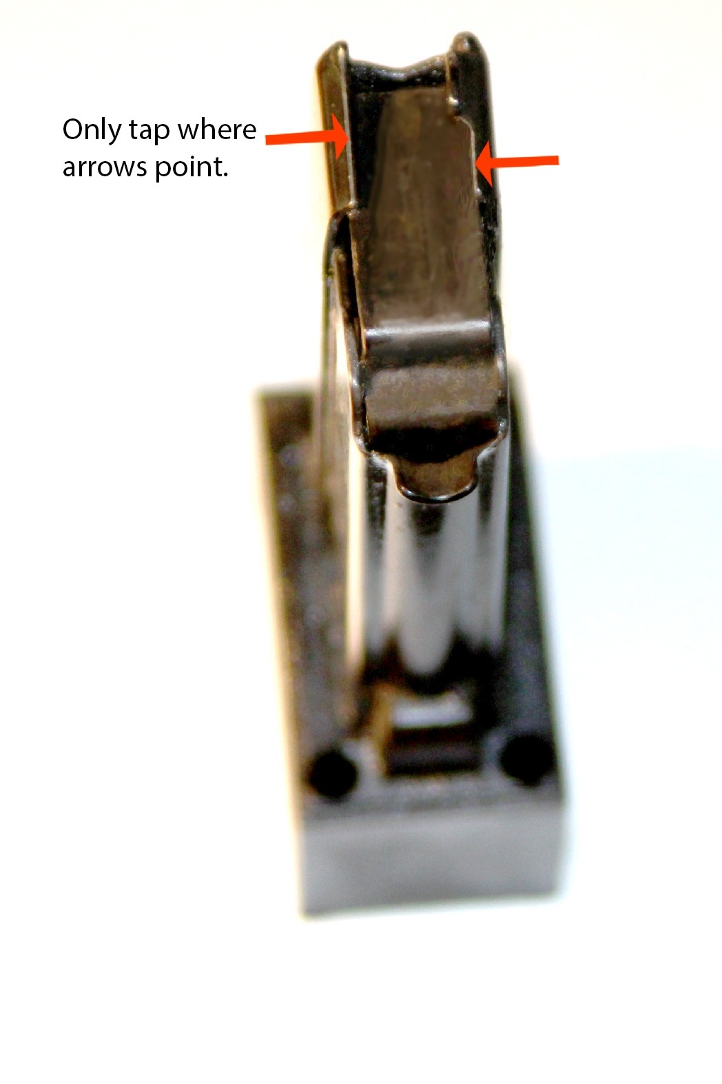

.32 ACP magazine fix
Oldcaster,
Can you describe what you did in " moving the rear edges of the magazines in about .018 fixed everything."
I have not found a definitive magazine type yet. Old ones with a flat back and light spring or new with a back dimple and heavy spring, some work and some don't of both types.

Mahoak,
In the post right above yours from Dipnet there is the link to where you can get the mold and which one it is. I went for the 5 cavity aluminum and I think everyone else did also. I like iron molds a lot better but the price differential is too great to go that way.

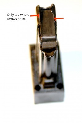

As far as the magazines are concerned, I put the magazine in a vice (be careful here as the magazine isn't that tough) and with one of them I moved the rear edge of the magazine opposite the ejector in around .009 with a 3/16 inch brass rod by hitting it in and down at an angle of about 45 degrees. Then I moved the other one by hitting it the same way right in front of the ejector.
The other magazine I put it in the vice the same way and hit in the same area with a brass hammer about 5/8 inch in diameter on both sides and didn't use the rod.
One magazine is now .286 across and the other is .283. At this point I have no idea if this is just enough or almost too much other than both work well now and neither did befo. Perhaps some of the other guys could chime in and measure how wide their magazine is at this point. It doesn't take much force to move them in that amount. Make sure you measure what you have to start with and then move each side half way because once it is done on both sides, there isn't any way to reference how much one side has been moved other than just looking at it.
If you want to try some of these bullets first, send me an Email MrWmLau@gmail.com and put in your site name also so I know who you are. That can get confusing otherwise.

I finally got many consistent 10 shot groups between 1.25 and 1.5 at 50 yards here is what I'm doing:
Old Casters bullet = Accurate mode 060A
Mine drop at .316" I size them to .315"
I'm using 50/50 lube as recommended by Old Caster
The method I'm using to reload is not how the reloading books read so I'm not suggesting that you do it this way. I'm sure there is a better way. I presently do not use an expanding die so all my brass needs to be the same make. Winchester gives me the smallest groups followed by Federal and PMC. Remington does not work with my set up as the brass is too thin.
I size my brass with a .336" carbide sizing die (custom made)
This with WW brass gives me about .314 ID (This is why I do not need to expand the brass with an expander)
I using Hodgdon TiteWad powder again this powder is not recommended for the 32 ACP so I'm also not recommending to use it. I've been trying to use VV N-310 which is great when I was using 1.8 grains but when going lighter I was having inconsistent velocities. I was trying to get the bullet to go about 750'/sec.
I'm loading 1.15gr of TW and this gives me 750'/sec and with Federal GM 100M primers consistent velocities SD's between 10 and 12 for 20 rounds. Winchester primers gave me vertical stringing and bigger swings in velocity.
My OAL is .880 with a .332" taper crimp. I tried OAL between .860 and .890 and they all were accurate.
.880 always feed in my gun.
I've done the magazine lip modification and run 22 springs in the magazine and also for the recoil spring in the gun as this load is close to a 22 load.
