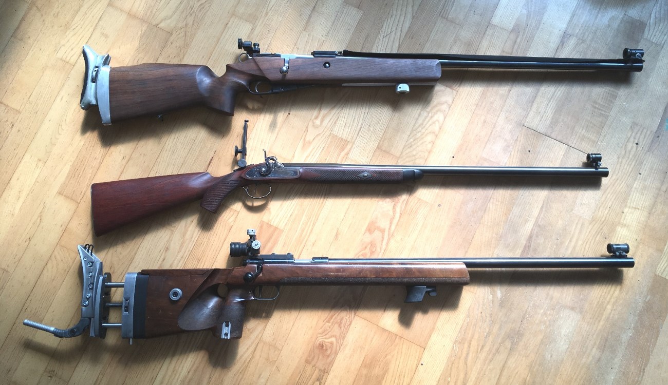

It´s been a while, but I still shoot with the 1613.
Have also shot 300m matches with old M27-66 7.62x53R rifle.
My latest gun purchase was a muzzleloading rifle: "Creedmoor Match" that I use in MLAIC events "Vetterli" and "Whitworth"
That Vetterli event is 13 rounds in 30min, standing position, 50m at issf pistol target. I cast my own bullets, but still it is 0.25€ every time the Creedmoor goes bang. So began to think that I could use that 1613 in training shooting from standing position during winter. No need for expensive ammo there, 0.08€ TopShots/CCI std´s will do just fine. But there is quite bit of weight difference...
Creedmoor is cal .45 and has enough recoil to bruise my shoulder if shot without a jacket; 290gr bullets and light (3.5kg) gun do that.
Just put the 1613 on a scale. It weights 6.5kg ready to shoot.
* 3kg for Stock & accessories (buttplate assembly weights 1.33kg)
* 3.5kg for barrel, receiver, bolt and sights
1613 could be made lighter. There´s no way to make it weight 3.5kg, but I´d be happy with weight of ca. 5.5kg ready to shoot. The barrel on 1613 is 70cm long, diameter 24mm. What would be shortest usable length with a bloop tube, maintaining accuracy for not so serious, clublevel prone shooting? 10cm of barrel weight ca. 330g.
Long guns, M27-66 on top, Creedmoor Match muzzleloader middle and 1613 bottom
Posts: 2096
Re: Buying old .22lr rifle
Hi Jiri,
The shortest I've seen on a match rifle is c. 50cm. I think the minimum length is more about balance than accuracy. Here in the UK hunters go for as short as 31cm (just over the legal limit of 30cm). But the muzzle of a barrel that short wouldn't clear your stock, and the balance would be horrible. Don't forget an aluminium extension tube will weigh 200-300g.
Another way to make the rifle lighter would be to swap the stock for a 1407, or similar. Even with a 70cm barrel, the rifle should weigh under 5.9kg, even with spacers to extend the butt.
