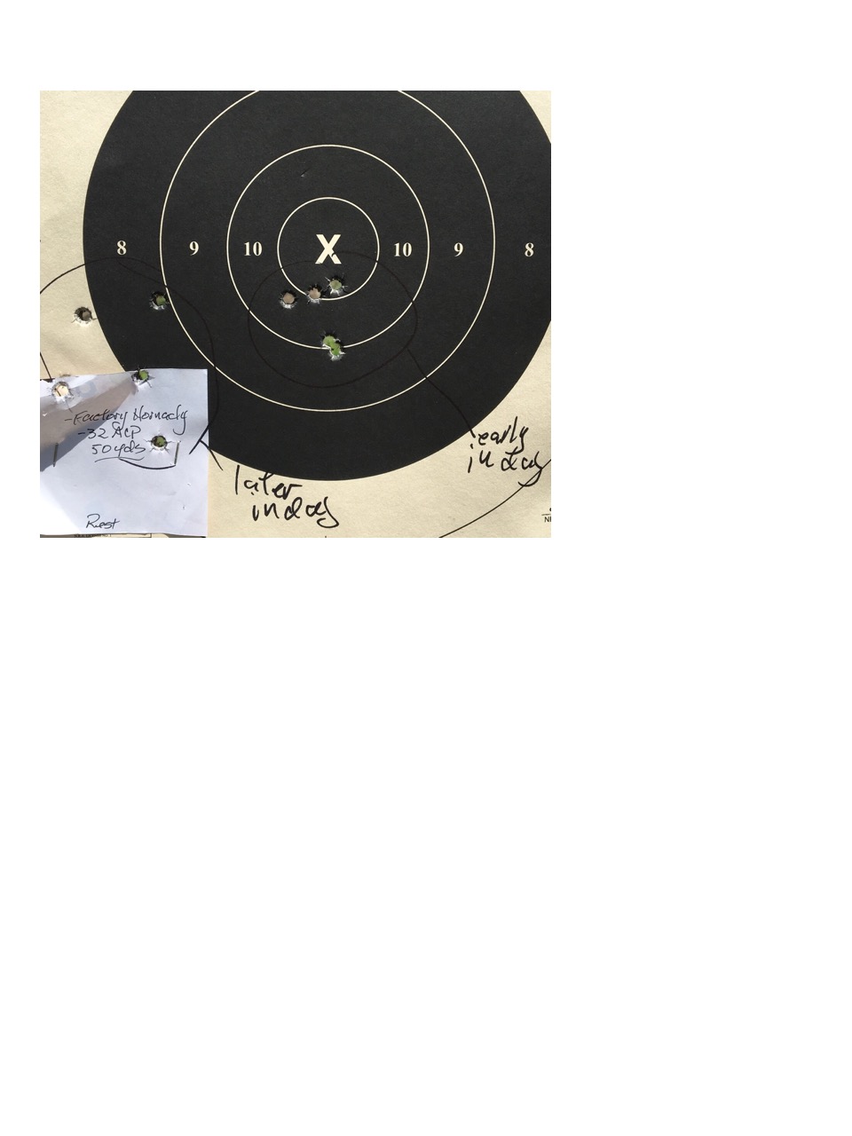

Hello again everyone. I was wondering if I could get some opinions on what is going on with this target. I was shooting a variety of load recipes, some with LSWC and JHP. This was a sighter target using factory Hornady .32 ACP. I shot the first, closest 5 rounds as a baseline then started shooting assorted loads. As I was shooting the other loads I gradually noticed the groups getting larger, every load terrible and a little worse than the previous. After about 50 rounds and probably an hour, I shot 5 factory rounds at the original target to see if I was still at a recognizable baseline. Imagine my surprise to see to group center move over and open up significantly. Same box of ammo. Scope still secure in place. (I was shooting from a rest and I had mounted a small rifle scope to the gun to ensure I was aiming at the same point). My older brother who shoots a lot suggests either a hot barrel condition or a fouling of the barrel. I suppose those are both good ideas but, really, after 50 rounds the gun pattern looks like this? From the great and powerful Pardini? At this point there is no predicting what load recipe would work if I can’t get repeatable performance. I suppose I will try to shoot the .32 one more time using a bore snake every 5 rounds but I am at the point where I think shelving the .32 Pardini and working on the 9mm would produce better results. Probably an dumb idea to chase this .32 idea just because I have a lot of money and time invested.

I don't have a Pardini 32, but have used the 22 a lot.
If I were to have an experience on the range like what Emmett has just described, one thing I'd check would be the tension on the bolt under the muzzle that holds the barrel to the frame.
Jim
Jim

Emmet,
I see one great group and one not-so-great and suspect something happened between the 1st 5-round magazine and the second (loss of sharp focus, trigger jerking, rest moved?). I've been slow to post data, but just updated my excel sheet on loads testing I have done for the 32 ACP; a pdf is attached. I think you will find that the 32 is very accurate, quite fun to shoot, and really easy to load accurately (essentially a mini 45 ACP). I only shoot mine during 2700s and at times when I'm behind on 45 reloading (you have to shoot a 45 well to become a master/high master (that's my goal). Regardless, I enjoy the 32 every time I shoot it.
I mostly shoot the 62-gr LSWC developed by Oldcaster and sold by Travis Bullets. I weigh each one and sort into 0.3-grain groups (small variances in parameters, e.g., bullet weight, crimp, powder charge) can have significant effects because these variables are small to begin with. I only worry about bullet weight groups for the long line; not nearly as important at 25 yards. You will note in my data (bottom of sheet) for the "75" grain Rimrock bullet (actually 77-78 grs.), that one 5-shot group was 1.3" at 50 yards and I wasn't using a Ransom rest. I was so elated I blew second magazine. Cheers, dipnet
- 32 ACP_Load-test data.pdf
- (65.61 KiB) Downloaded 604 times

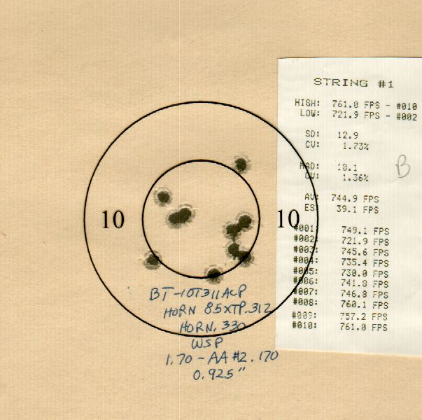

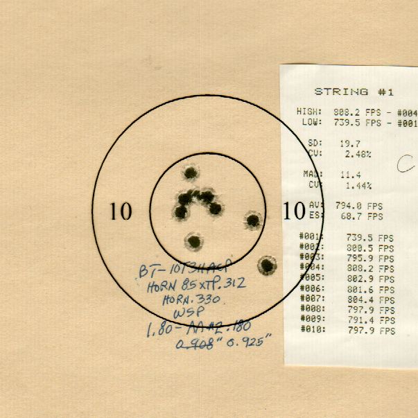

Greetings,
Tested some Hornady 85XTP bullets in the 32 ACP yesterday. Initial groups look promising.
The only on-line data I found was from Accurate Powder website.
If anyone has a new Hornady Load Book, see if they list loads for the 85XTP for the 32ACP. If so, PM me the data so I can safely test other powders.
