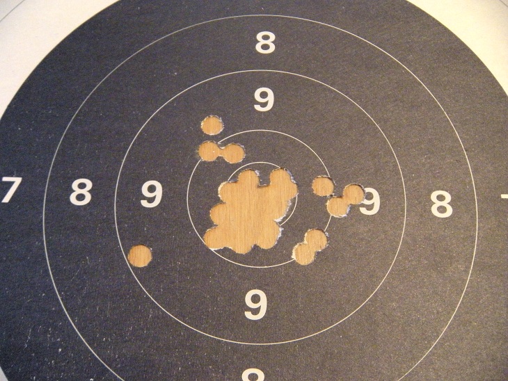

I am doing it all again for a hammarli SP20rrs ,it slugs in at .314".
Finished making a new neck sizer die at .314 (factory are .312) and using a 90g cast projectile (HBWC are nil stock at the moment) with 1.8g trailboss powder.
Trailboss gives a better case/powder density, being bulky it fills the case more and gives very consistant loads. I did have to modify the powder thrower to throw it evenly.
98g HBWC, 1.7g Trailboss, 25m with Tesro pistol free standing ISSF centrefire match.
