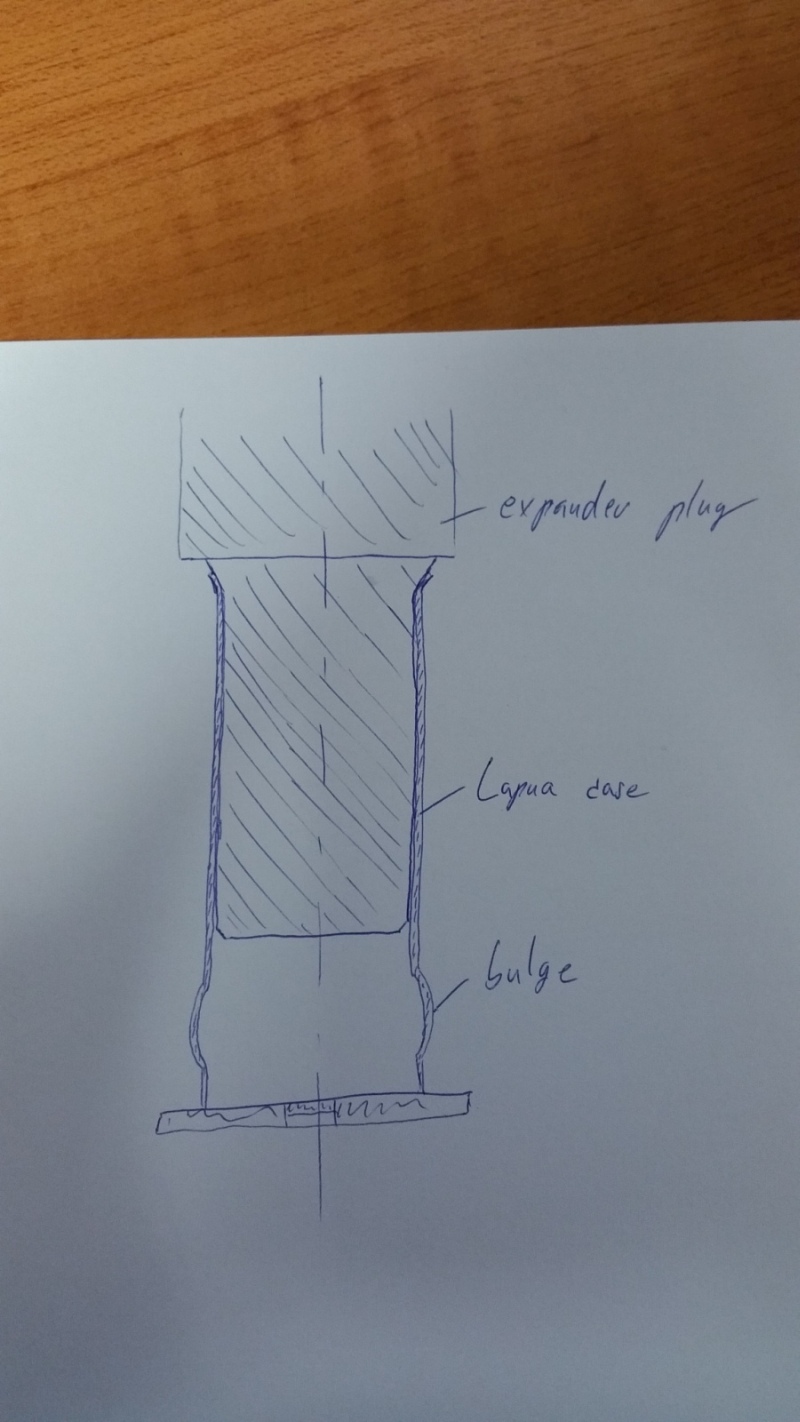

Hi Jakub,
It's hard to tell when the pic of the case is so small, but I think the case mouth may be contacting the shoulder of the expander or the case wall is thicker towards the rim. What brand of brass are you using.
I'm sure we can help
shootaholic
shootaholic

Re: Pardini HP 32, ammo talk
Hi Shootaholic,
I am using only Lapua brass.
Included simple drawing for better understooding...hope it will be clear.
Hi Jakob,
Ok, from your sketch it looks to me that, you need to raise your expander plug as it's crushing the case. Just give the case mouth a very slight flare so the projectile will seat without shaving lead.
Let us know how that goes.
regards
shootaholic
regards
shootaholic
I had this problem once. 3 reasons:
1.My calibration/ decapping die was made for .311 bullets.
2. I made the expander 0.4 mm too long.
3. Expander was made of too soft material.
Valve grinding paste took care of nr.1. Yes, it was carbide.
2 and 3 was solved by making a new expander. Drillshaft, highly polished and maximum hardened.
I also used H&N bullets, 98gr, and Lapua brass.
Yes, the case bends, because it is to narrow and the friction is to high. Lubing helped me very little and lifetime of the case is low with too much work.
Lubing is a mess and an extra step wich I avoid by not needing it.

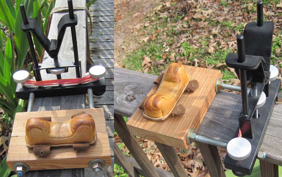

rmca,
sorry for the belated response but kept forgetting to take picture of rest. It is a modified HySkore red dot pistol rest. I basically took off the rear part, installed all-thread rod, two 2x4" pieces of wood clued together and drilled to fit all thread rod. The rest comes with adjustable feet in the front to aid in leveling it and an adjustable barrel rest (for adjusting elevation). I use the front part of a rifle rest sand bag to rest the butt of pistol on and try to hold the pistol as close to possible in the way I hold it when shooting. I can get very accurate groups with it at 25 yards and sometimes at 50 yards.
I should just buy a 6x pistol scope and use it for 50 yard sighting in (Warne makes some well built quick detachable scope mounts for around $50). Image attached. Best, dipnet
PS: The rubber bands are to hold barrel still for mini reflex sights where you move the dot to the hole of the last bullet fired (simply keep pistol ~rigid when adjusting sight).
Dipnet,
Thank you very much. That image helps a lot.
I was thinking of getting one of those rests, but was unsure that it will be repeatable enough to test from.
Your results prove my fears are unfounded.
Thanks again!
