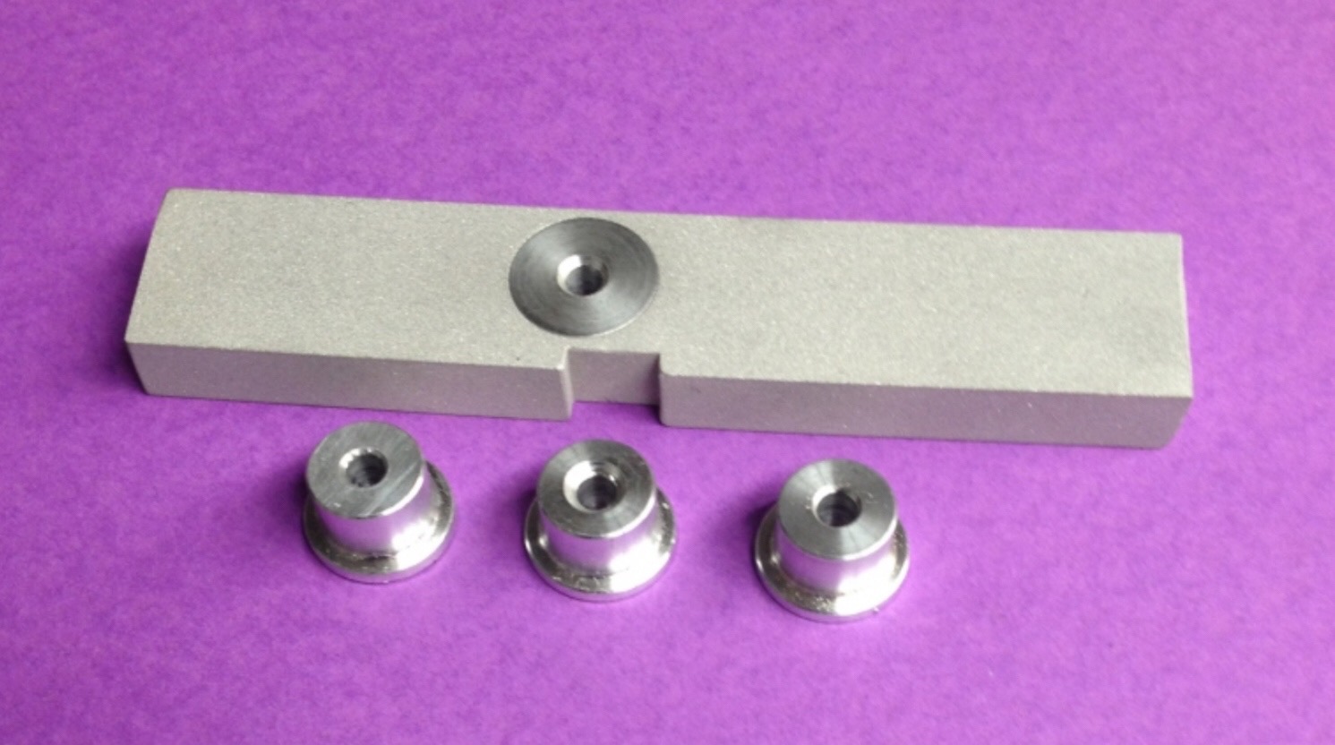

JamesH wrote: Sun Aug 21, 2022 4:54 am I made a set of bars with drilled holes for my RL550, I don't think they give better accuracy than the adjustable bar but I can go directly to the load I used before.
There was a guy down here in NSW in Oz who made a powder bar for the Dillon 550/650 which used aluminium replaceable inserts which you could drill and ream out to get the load you want for the powder you want to use. Swapping inserts is easy without having to completely remove the bar. I find it great for very small loads (~1.4gn). I never had much luck with the Dillon extra small powder bar. The shape of the measuring chamber in the bar is just not conducive to repeatability. Unfortunately, the guy who made the bars has retired and no more stock, not even the inserts. If I was lucky enough to have a lathe…

BobGee wrote: Tue Aug 30, 2022 2:21 am
I sort of half thought about doing that for a while but just drilled out some bars that I had machined.
I found no difference in accuracy between the adjustable charge bar and the drilled holes but then 7.62x26 and a 1:10 twist in a choked barrel is very forgiving.
I have seen some increase in SD over ~15 years, I think its powder deterioration.

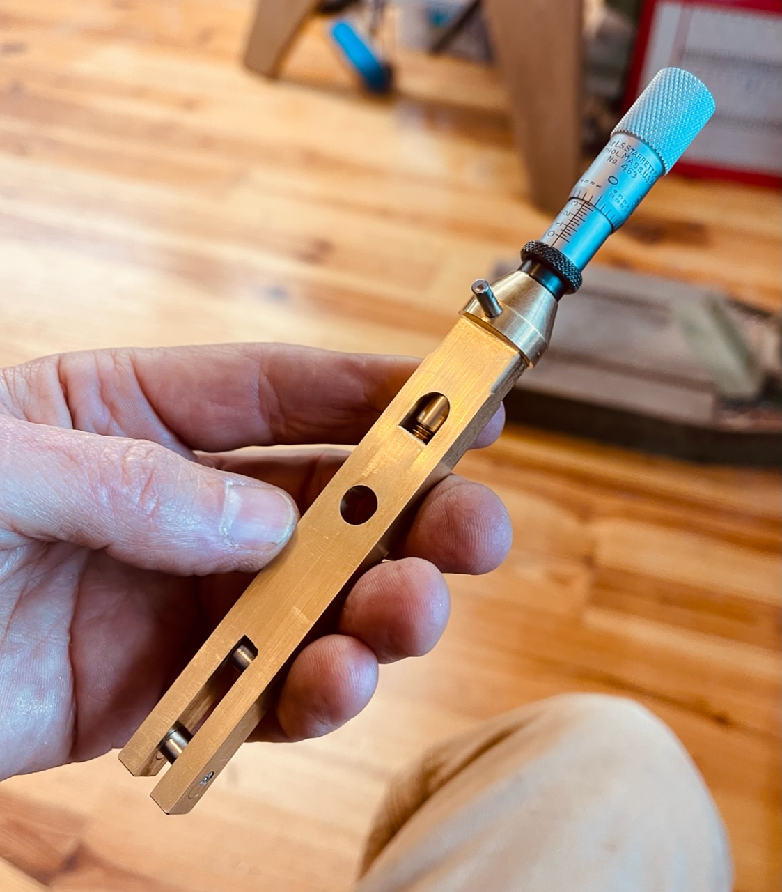

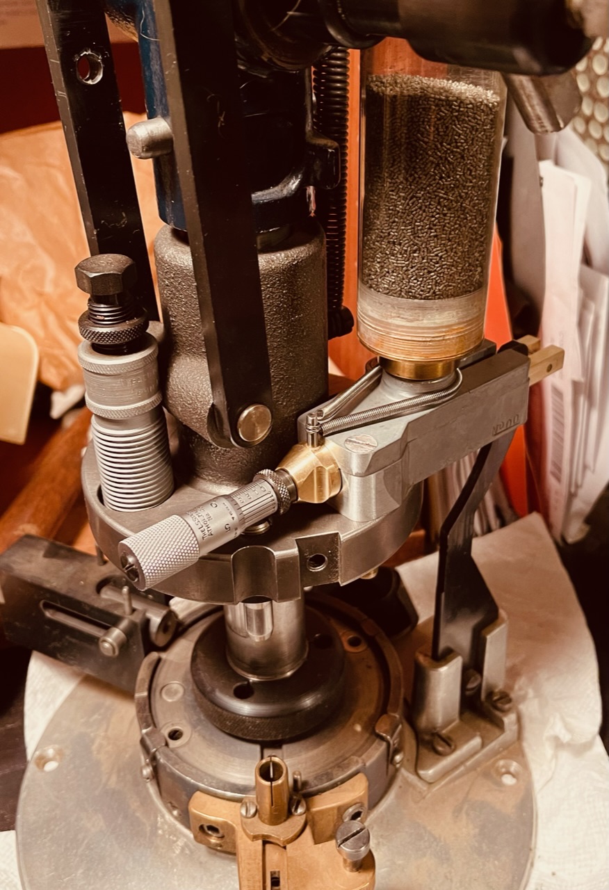

So I have gone with the adjustable slide route.
This is a micrometer slide I made up for the Star '00' powder slide housing.
I am getting perfectly consistent throws to the resolution readable on an M5.
It is as always a work in progress- I am testing to see if I want to make another for the '0' slide specifically for the 32.
So far I am quite pleased with the mechanism- the results are consistent and repeatable after changes.

trboat wrote: Sat Dec 17, 2022 7:06 am So I have gone with the adjustable slide route.
Very nice work! Should you offer altering the slides as a service, please count me as interested. Having to figure out your powder's bulk density and then machine bushings based on that is sub-optimal.

That powder slide was turned from bar- that is entirely built from scratch.
I turned and milled that on manual machines but did consider drawing it up to see how much a shop would charge to make a short run of the body’s.
I am pleased though.
I made this to very close tolerances and it is throwing consistent charges.

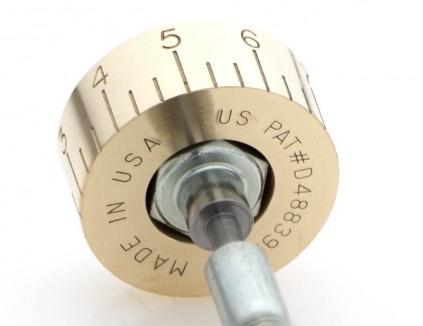

JamesH wrote: Mon Sep 05, 2022 5:38 am
I found no difference in accuracy between the adjustable charge bar and the drilled holes…
After reading a thread in the Bullseye-L forum on reloading using the Arredondo micrometer bar from UniqueTek* wherein a poster said he got no real difference using the Arredondo product (and from JamesH's comment above), I have decided to go back to the adjustable extra-small charge bar but with a simple mod: the addition of a MRDial adjusting knob. I had a problem with the set-up initially because the screw supplied with the MRDial knob was too short for the extra-small bar so the insert in the bar would detach from the screw when screwed right in meaning that it was not possible to get a zero - the knob would just spin. I now see that there is a version of the knob specially for the extra-small bar which, presumably has a longer screw - not sure if that was available when I bought mine a few years ago. I found that I had the longer screw from the original extra-small bar set-up so drilled and tapped the head to take the Mr Dial fixing screw and am now able to screw the insert in to a physical stop where I have set the knob's zero. So now I can progress to get repeatable settings. Odd thing about the dials is that they have only 2 marks between the numbered marks on the dial, i.e. 1/3rds - strange. I think that the dials for the small powder bars might be marked in 1/4ths.
* https://www.bullseyeforum.net/t19186-ar ... =Arredondo
I have access to Bullseye, Vihtavouri N310, WST and ADI AP50N powders so an adjustable bar is a decided advantage.
