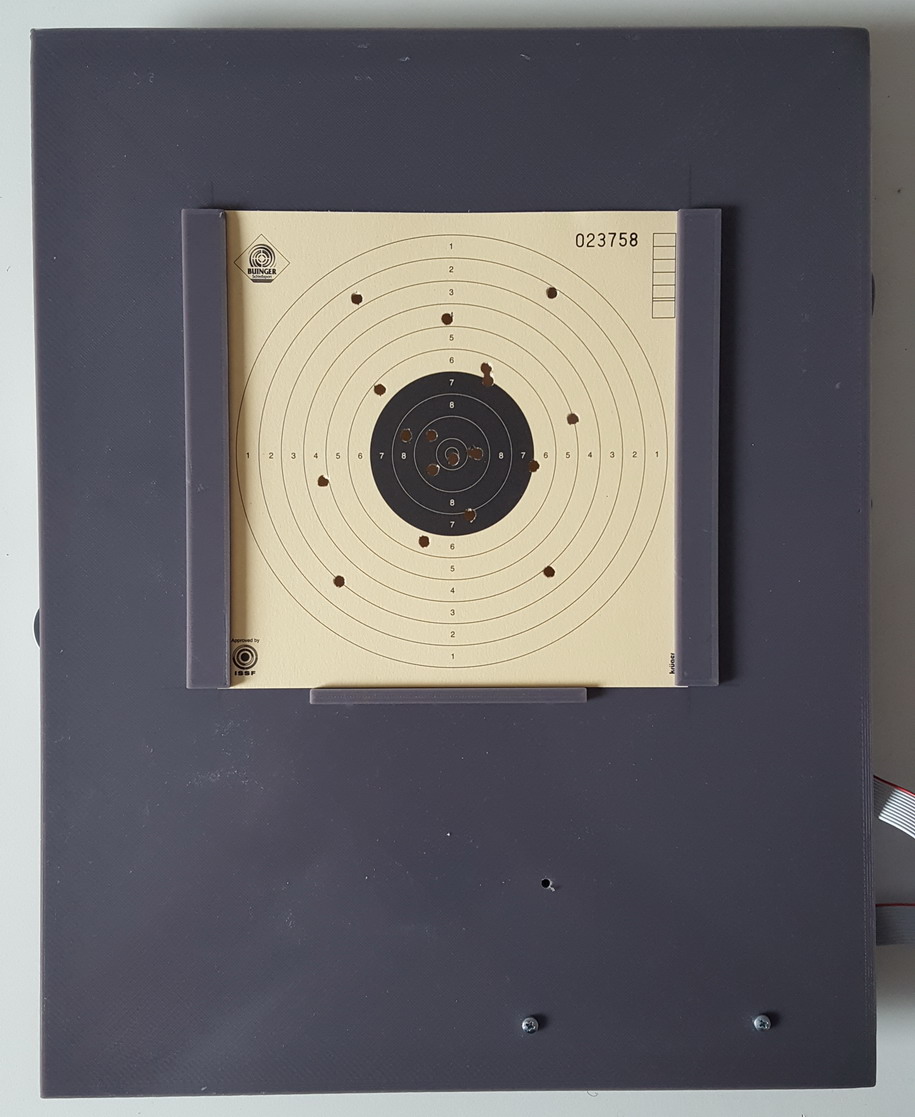

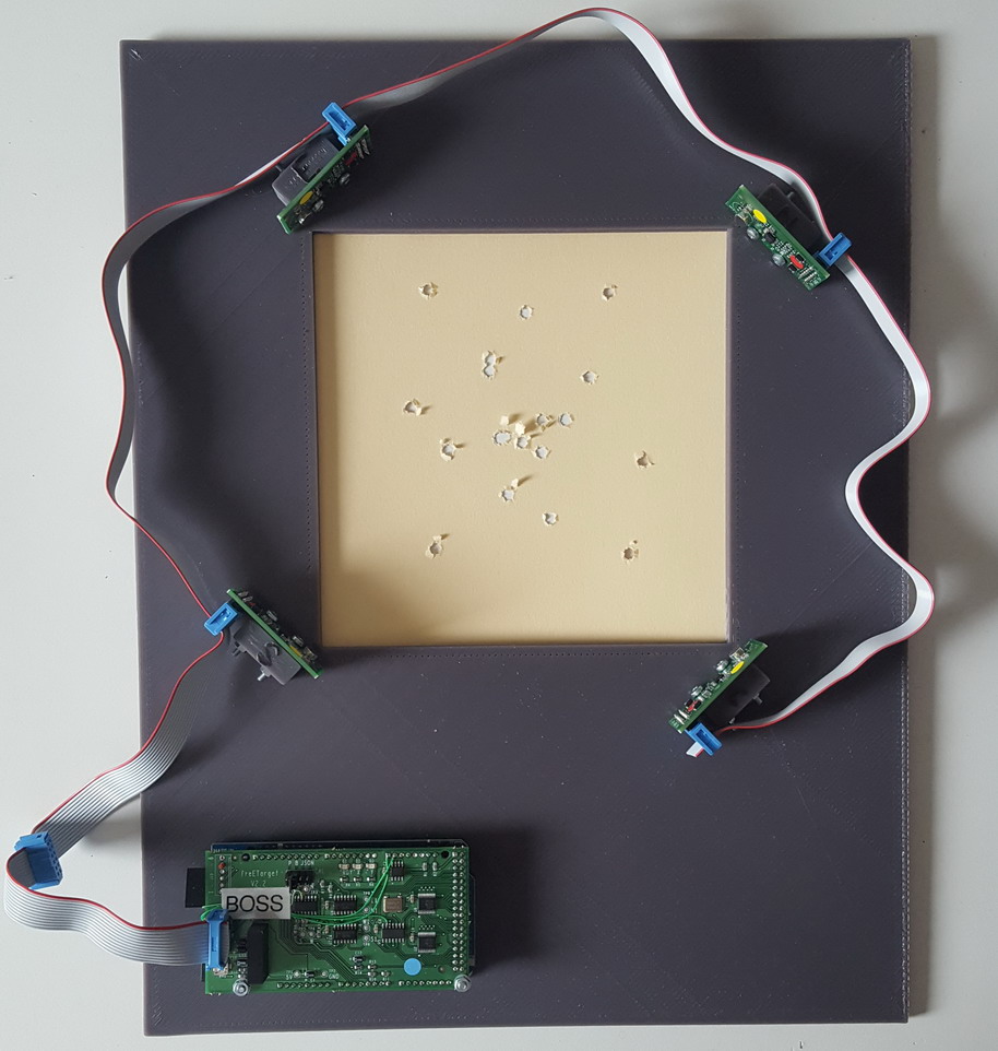

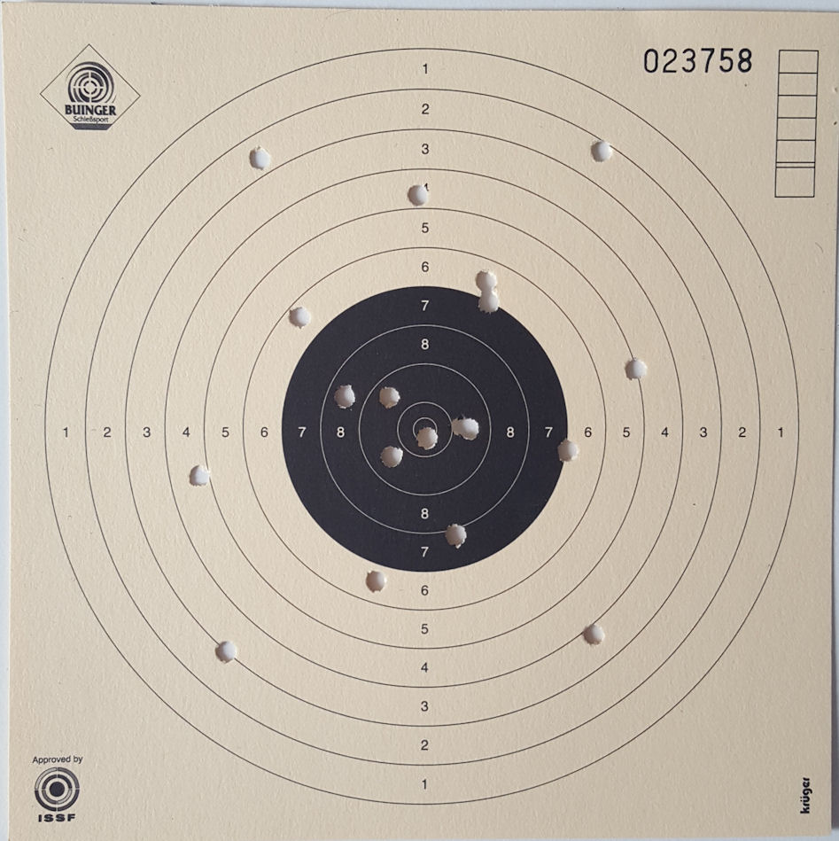

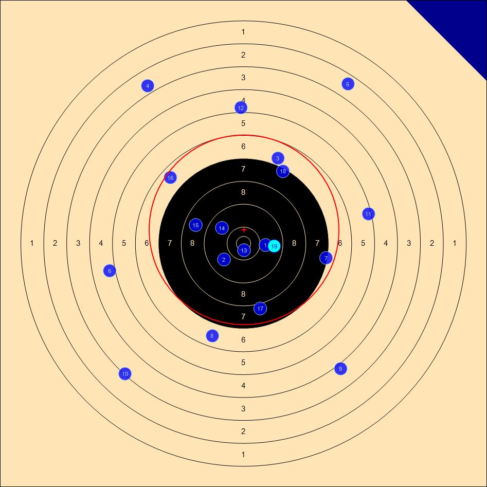

tested another set of boards together with a 3D printed target face.
accuracy looks pretty good

the STL files for the 3D printer are on the site. 3D printers are quite common these days. even if you don't own one, you can find a printer shop nearby to do one print for you. if i could find a 3D printing shop in the middle of Transylvania, you can find one in the great US of A :)
each builder has the option to use the files or build the target housing after their own ideas/design
