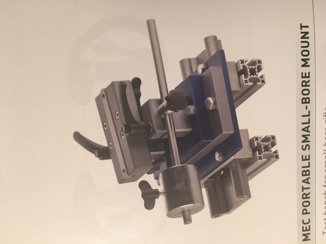

Back from ISAS Dortmund and some indoor 50m fun... not me unfortunately but a very helpful Anschutz servicing visit instead. I picked up all the catalogues and have to post another rig for the compendium. It's the MEC portable.
Some in depth discussion with people who seem to know gave me the impression that rotation is negligible, so I'm not going to worry about it anymore.
