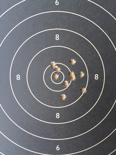

Bryan996 wrote:The targets were shot from the shoulder with iron aperture sights.
Hi Bryan, as Kevin so rightly says (although I may slightly disagree with his percentages) the errors from hold, aim and conditions will make it very difficult to objectively rate the groups. The vertical might be down to you or might be down to the barrel/ammo.
What I have been doing this summer is ammunition testing using SCATT (either from the shoulder or firing from a bipod) to confirm Point of Aim and quality of Hold/Release.
I have had a few batches of selected ammo that tested well from a fixed rig but when it came to shooting from the shoulder (with SCATT indoors at 50m on electronics) it became apparent very quickly that one batch put the shots where I was aiming them whereas the other batches produced unexplained stray shots.
I've seen similar results with other shooters too - shots that SCATT would say are deep 10's but which print low with selected ammo...
That said, I use and believe in tuners - I have one for each of my barrels. They seem to be working for me this week...

kevin nevius wrote: These are good targets IMHO.........I would take them most days in pretty good conditions!! I have found that I gain more reduction in group size just working on hold and aperture size...... I would take a 197 @ 100 yards on that target any day of the week
Thank you for those positive comments Kevin, I seem to do most of my training by myself these days so it means a lot to get good feedback, especailly from someone of your standing. One question for you though, how do you find aperature size effecting group size?
KennyB wrote: I have had a few batches of selected ammo that tested well from a fixed rig but when it came to shooting from the shoulder (with SCATT indoors at 50m on electronics) it became apparent very quickly that one batch put the shots where I was aiming them whereas the other batches produced unexplained stray shots.
Ken, I have found similar results. At the batch testing a lot of centre X actually tested slightly better than the midas, however shooting them both from the shoulder the Midas was clearly better. Ive attached a photo of the centre X shot on the same day and although the group isnt centred it shows the larger group size. I am beginning to realise that I do need to invest in a scatt system, maybe its time to sell the spare 1913 in the cabinet? Where in the UK do you shoot 50m indoors in electric targets? I didn think we had such a facility.
It looks like I'm going need to buy a tuner (after I've experimented with tube torque settings) to see if I can gain any benefits, everyone who has contributed who shoots high scores all seem to be using one! Thanks for all the replies

Mark D and Kevin always have their equipment in top shape.
From the look of the groups, there is potential for gain. A tuner could help, but as this was shot with iron sights in a sling how much error came from that?
I would shoot some more, and as Kevin said focus on shot execution. If that is perfect in these groups my then a tuner could help.
As Kevin said, you have to be ready for the weight gain. I took almost a half pound out of my stock this summer to make up for the barrel/tuner weight addition. Breaking a clean shot and fatigue are not to be over looked.
