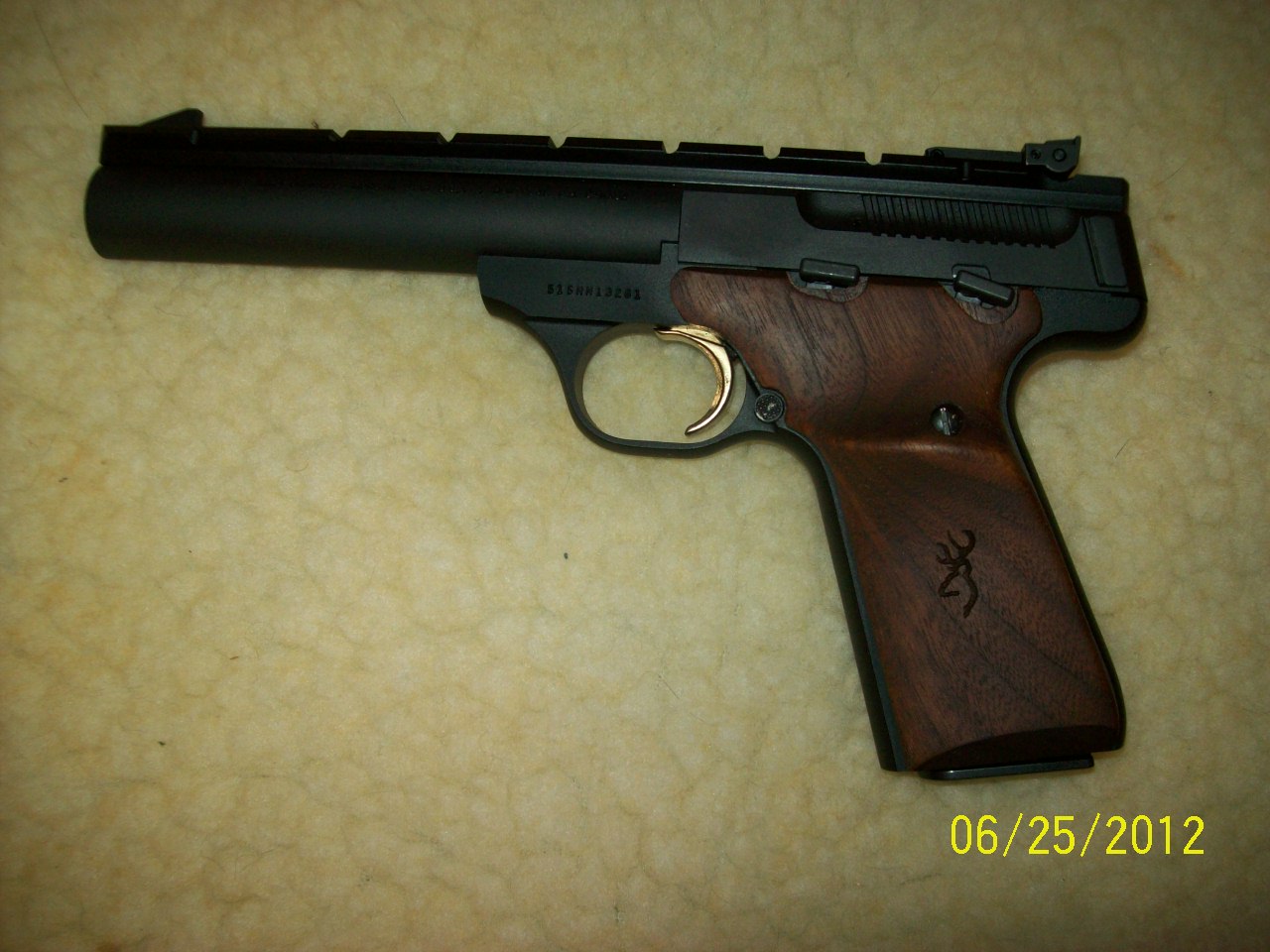

Here is the Browning Buckmark I settled on
A good hand fit..so far. Need some more magazines of course and will eventually get a optic sight.
Am pondering making a set of grips to match my Izzy AP in at least the hand hold part. The slide release and safety latch area will have to be exposed as will the mag release.
yeah I could call Fung and for $180 get fitted target set..But a friend can get me some walnut or cherrywood and get it down to a dremel manageable size. I am patient and will take my time.
Might have to consult a rule book or two to be certain that the grips when finally attached will meet specs. If not..alittle more "dremeling" wont hurt.
