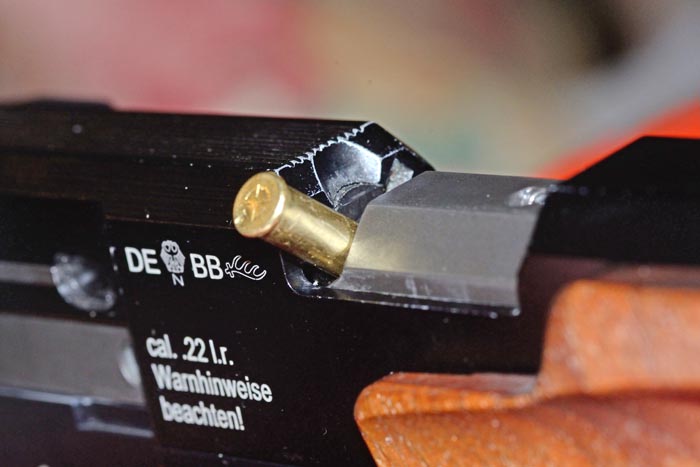

If the jam looks like the picture attached, the problem is a failure to eject. My understanding of how shells are ejected is that the shell pushes the slide back, the shell strikes the ejector and pivots around the extractor and is thrown clear. If the extractor is damaged or not fully engaging with the rim, the shell may just be dislodged from under the extractor to early to fully eject.

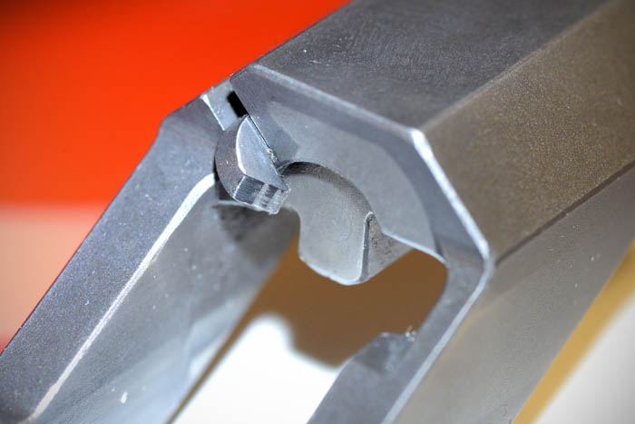

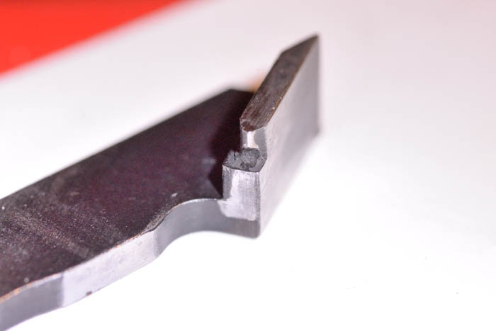

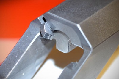

Attached is a pictures of my SSP extractor, it works fine. On my SSP the extractor is pushed sideways when a shell is pushed into the slide face. The striker/firing pin contacts the chamber face well away from the chamber, and has a broad contact area, I cannot see how it would hurt the chamber. Striker picture attached.
The slide would have to be binding and not moving through its full travel for the shell to eject so badly as to get caught like this. Hopefully this should be easy to notice. My SSP even when it has fired a 1000 rounds without cleaning still works ok. Mine has only failed to eject twice in its life, it is five years old.
