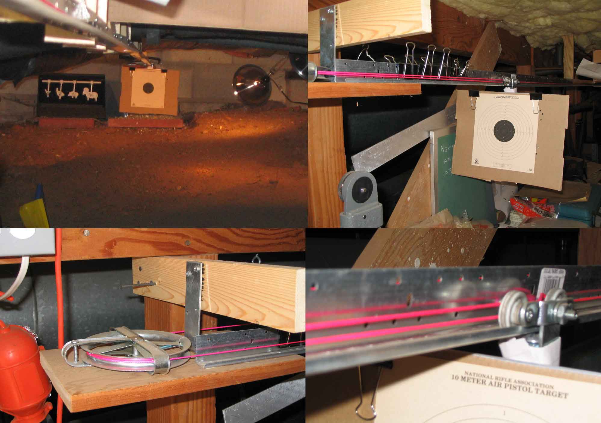

Similar to Fortitudo, my range in in the crawlspace under my house, except the target end is really a "crawl" space. So I had to rig up a target carrier also. Mine was made from various parts from Home Depot, very low tech. Under the 1x8 below the pully is a hand crank. A motor would be nice but the hand crank was "good enough."
