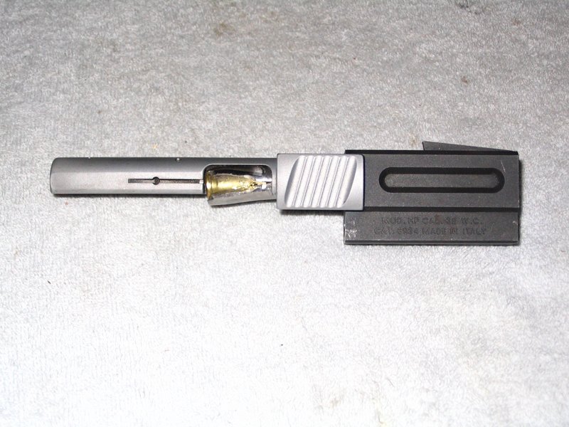

It could end up like the attached image...
Re: Pardini HP 32, ammo talk
fc60:
Ouch! Could you explain what happened. I assume that was a 32 S&W L? dipnet
It was not my pistol so I cannot say with certainty what happened. I suspect a "poofer" round did not clear the barrel and the next round fired.Dipnet wrote:fc60:
Fortunately, I was able to remove the old barrel via end mills and several setups. The owner had friends in the industry to check the bolt with MagnaFlux and it was okay.
I machined a new barrel for him and he is shooting with us again.
In summation, the above had an equivalent of a 196 grain bullet and too much pressure. Seating bullets deeper, as suggested earlier, increases pressure a lot and is something I would not try.
STICK TO THE LOADING MANUALS! Those folks know what they are doing.

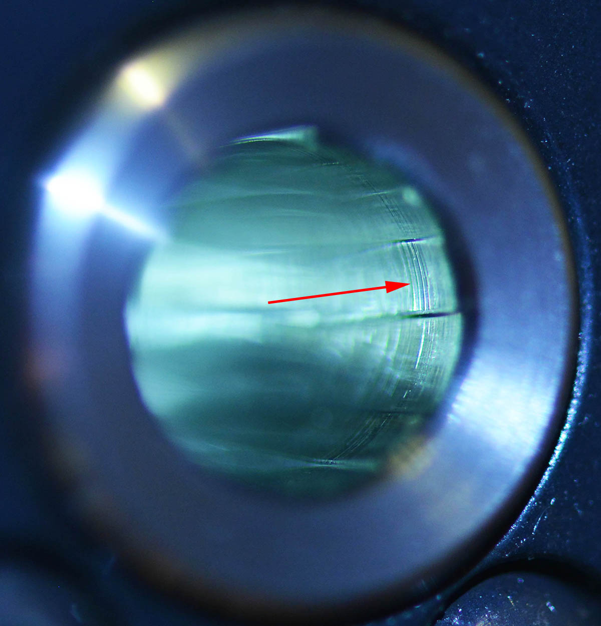

I had a so-so day at the range testing loads using the 62gr. LSWC bullets (0.314) at 50 yards using a ransom rest. I may not have had the pistol properly seated in the rest, or there may have been a problem with adapting the rest base to the concrete benches at my club's range. All of the 10-shot groups were vertically strung and ran 4-5 inches c-c (these were actually two 5-shot groups of smaller diameter that overlapped).
I'm not sure what I learned. I am going to rebuild the way the rest attaches to the concrete shooting benches to make sure it is absolutely ridged. I've been using Federal match primers and noticed that there was a relatively large amount of unburned powder in the spent cases when I deprimed them. So, next time, I am going to compare these loads: 1.80gr Titegroup, 1.50gr. Titewad, & 1.60gr. VV N310 (all with Federal brass, OAL=0.880 & crimp=0.333) with Federal, CCI, and Winchester primers.
I tapped one of the lead bullets through my barrel and it measured 0.313 inches across the lands. I've measured the diameter of Hornady XTPs and they are 0.311, which makes me wonder how they can be so accurate? Have any of you slugged your barrels? What barrel diameters have you measured?
The groups may tighten up using 0.315 bullets (I'll get a small sample of these from Travis). One thing that really stuck me was the incredibly small sd's obtained with Titewad powder (see attached test data). Also, I thoroughly cleaned the barrel to remove any leading and subsequent close inspection revealed that the barrel was never lapped, which surprises me (image below shows striations on lands). Any thoughts, suggestions. Thanks, dipnet

Since it doesn't appear to matter much what your barrel diameter is, why don't you you firelap it yourself. Use bullets proven to be crappy. It doesn't get any cheaper than that.
Rover,
That's the first thing I thought of, but after reading about recent reports on fire lapping tests, the benefit of slightly increased accuracy appears obviated by increased throat wear. At least that the controversy. Granted, that may not be an issue in 32 ACP. I just don't know. I would have to hear from knowledgeable gunsmiths before I did this.
The folks at Pardini were not able to get back with a detailed response to my inquiry but I gather this may be the way they release the barrels. You have to look at the lands under slight magnification (~10x) to see the cross striations. Maybe they are no big deal. I do know they are not on my 22 barrel and I don't need no stinking Ransom Rest to put CCI paper box into the Xring off a sandbag.
Any rate, further load experimentation needed to see if I can hit the 2-inch realm at 50 yards. Dipnet
