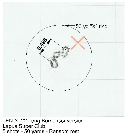

Hi All,
I have done some testing with the GSP in .22 and .32 in longer barrel configurations for a product we are starting to offer for shooting the NRA with the GSP.
I can confirm that the gsp in both calibers does well out to 25m but they "fall apart" after that. The .32 especially has issues past 25m.
Increasing barrel length out past 6" works wonders for the Walther. Our .22 barrels have all been sub 1" at 50 yrds with the good ones capable of sub 1/2" groups. These groups are shot with one rather inexpensive ammo (Lapua super club) and ammo selection would bring this grouping in tighter. The stock Walther barrel struggles to keep the groups in the 50yd NRA X ring (1.75"). The barrel also makes for a fine handling gun.
The .32 is a different beast and we have achieved a 300 to 400% decrease in group size at 50 yds. The slow wadcutter destabilizes past 25m and 6" groups are the norm at 50yds. We are able to get the GSP .32 to 1.5" at 50 and I am sure with further testing we will get this in tighter. We use a tighter (.311) and faster twist (1 in 18) barrel than walther does.
We have just started production of these conversions - for info see our website at
http://www.sasktelwebsite.net/samoc/home.html

- targets001.JPG (41.92 KiB) Viewed 4663 times
