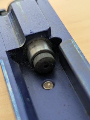

I’m taking possession of an AW93 light and understand there is a rubber buffer.
Im writing to ask if someone could confirm the part number. I believe it’s 3.5.560.122 “damper”

It's a rubber buffer, but you'll never need to replace it. It sits on the end of a spring-loaded plunger and it only comes into play at the very end of the slide's rearward stroke, if the plunger becomes maxed-out. With any match-grade pistol cartridge the buffer will barely be compressed.
Honestly, this is one of the least parts-replacement-required pistols you'll ever own. Keep it reasonably clean and don't mess with it, it will serve you well.

Re: FWB AW93 light rubber buffer
Of course, but I really do think this one will last. It's black rubber, maybe synthetic, and the spring plunger does all the buffering. You can see the carbon smudge in my photo, that's about half the travel. It is at the back of the moving weight facing forward btw, which contacts the slide, not the frame.
