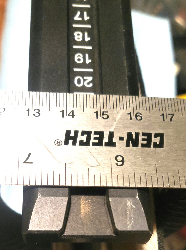

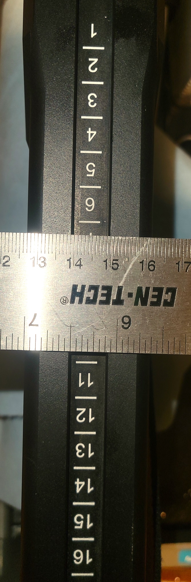

I have one - will get you the measurements this afternoon.

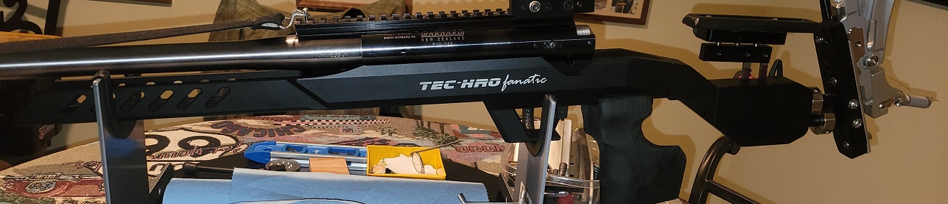

Hope this helps.
Ordered mine from Oberleenterprises in Oklahoma:
https://oberleenterprises.com/product/t ... -series-1/

Extremely helpful, thank you so much!
How do you like the stock in general? I'd likely only be using it for prone.

I have had three different barreled actions in it, Anschutz 2013, Walther KK500, and Barnard P for my Palma/center fire mid/long range activities. The Barnard setup is what is pictured. I made some changes to cheek piece & butt plate to get it to fit me and am very pleased with it. I also have an Anschutz Precise stock that I like for my smallbore rifle, purchased the Tec-Hro, so I could have it be my center fire setup. Only used for prone.

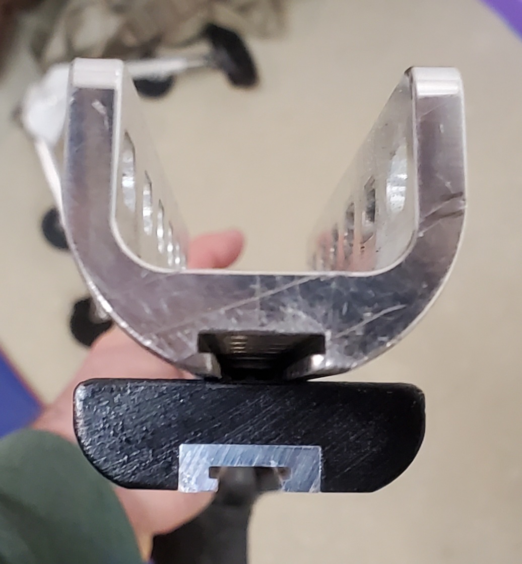

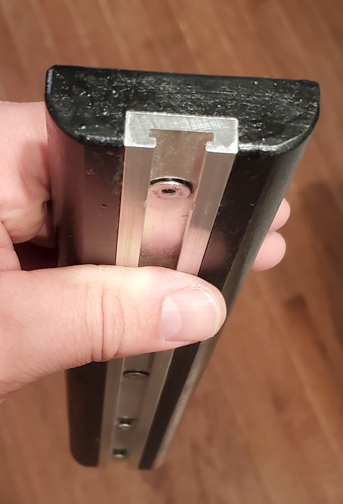

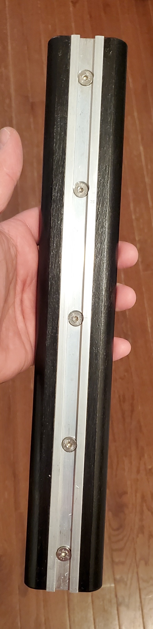

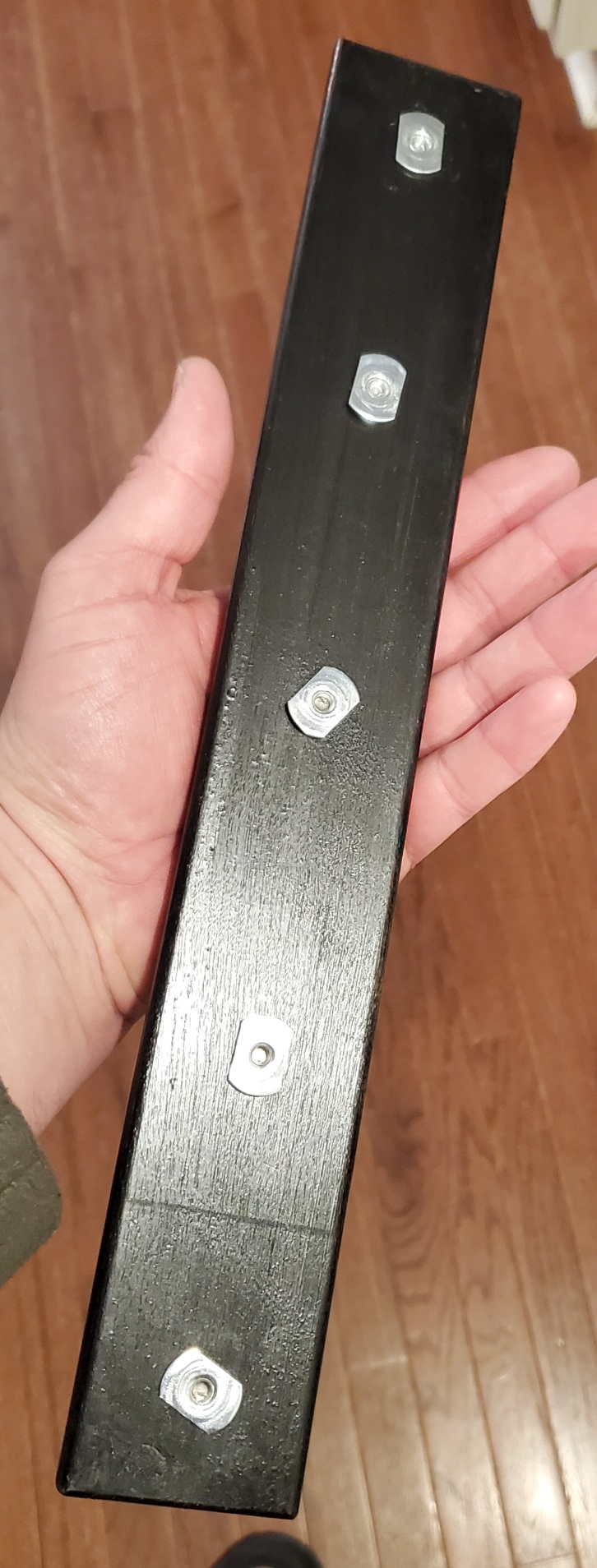

Another option to increase the forearm width or change the corner radius is a bolt-on forearm section.
I've made a few for guys that preferred the height and corner radius feel of an 1813-style forearm over their Precise stocks. The last one I made was for a Fanatic stock. Depending how you orient your support hand, the relatively small radius corners of the Fanatic can really hurt.
If you're interested, PM me. The ones I make use T-nuts to mount to the existing rail, AND have a section of Anschutz rail for mounting a handstop on the same surface your hand touches.

Ah yeah, those squared-off corners were also giving me pause. I appreciate the suggestion and offer! I'll keep that in mind as an option.

Hey 'Greyhounds,
While I did not mention it, changing the profile had skittered through my addled brain. Nice solution.
Where are you getting the forend rail? In the era of aluminum stocks fewer and fewer supply housed carry rail.

'Dude,
Thank you. You can get blank rail from Freeland or replacement Anschutz rail with scribe marks and holes from Champion's Choice.
https://freelandssports.com/product/ans ... ection-15/
https://www.champchoice.com/mc-firearm/ ... rts/003297
These T-nuts fit in the Anschutz rail profile and work well for coupling things.
https://www.mcmaster.com/90594A320
