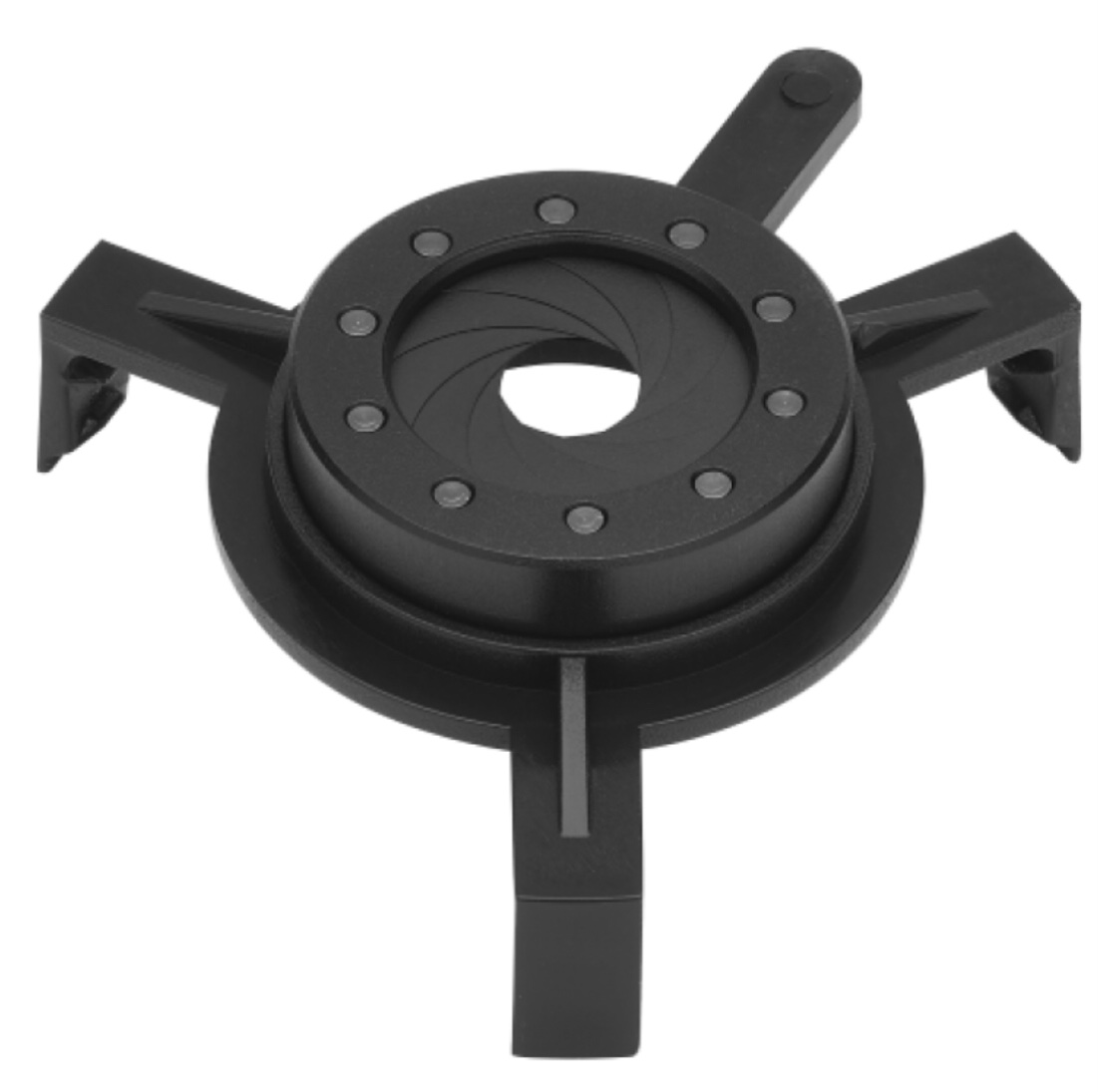

My aiming has struggled for some time. I did see the ophthalmologist last week and found that my cataracts are also mild...too soon to operate. They recommended an iris for my pistol shooting glasses. While it is too soon to be sure this is "the fix," it does seem to help. I do still need to adjust my head to find the clearest spot in my vision, though. Perhaps an adjustable iris for rifle sights?

Cataracts tend to form at the center of the lens, but not precisely so. Sometimes, you can see around it - especially if you can put a filter on the glasses that will open up the iris and let light go through the portions of the lens that are not occluded. I wound up shooting a MLAIC World Championship score on a horribly overcast day...but my eye opened up and I could see the sights!
