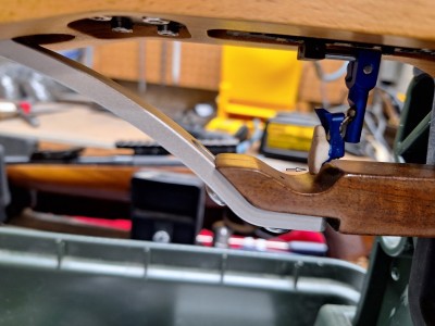

Nicolas, I call it a shoe. I've got a Senseive that I've adjusted as far down as possible with a lump of modeling clay on the cusp. Probably twice as far from the fulcrum as designed.
I doubt any of y'all would be comfortable with 6 grams.
Gerry

analretentive
Posts: 67
Joined: Tue Jul 09, 2019 2:53 pm
Re: KK500 Maintenance
Post by analretentive »
Weird , huh? I'm not insane. I shoot benchrest and the only thing I come in contact with on the entire apparatus is the spot indicated by the arrow.
gerry

nicolas G
Posts: 34
Joined: Mon Oct 16, 2023 7:30 am
Post by nicolas G »
Gerry,
thank you very much for the photograph.
