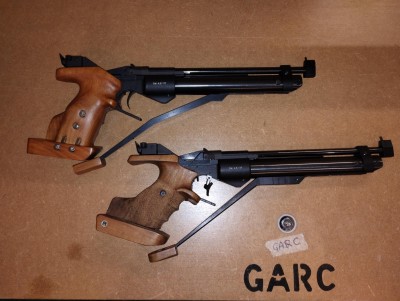

My IZH-46M Izzy has been poorly for a while. It suffers from a rolling and intermittent combination of not cocking, compressing, leaking and drooping bolt block. I've never worked out whether it's got one overarching problem or a few minor ones in combination.
To start with, the bolt block doesn't go all the way back and engage the trigger sears as it once did unless I perform a violently fast outward stroke of the charging lever allowing the increased speed/momentum of the block to travel fully back and engage.
My suspicion is that the bolt bar, the rod connecting the slide latch to the bolt block, has an elongated hole which is losing an all important couple of mil travel at the end of its stroke.
The hole has some wear but it seems minimal. I've nothing to compare the size of the hole to so can I ask my fellow Izzy fans if if this looks normal please?
Another issue I'm having is, that with the bolt block thumbed back fully, I can get the Izzy to compress but, when I push the block back down, there's a hissing leak from the transfer port. It's most noticeable if done slowly but a fast pushdown of the block allows reasonably consistent shots in the 450fps range.
Anyone seen and repaired this fault before?
