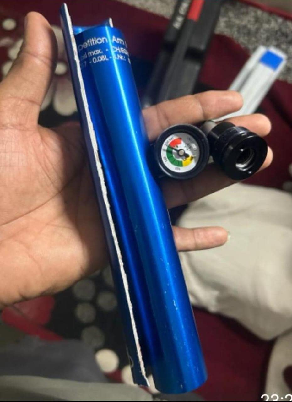

Never ever try to overfill the air cylinder. Never ever.
https://timesofindia.indiatimes.com/spo ... s?from=mdr
Posts: 1718
Re: Over filling cylinder
I don't know that it was overfilled.
Look at the photo with the end caps in his hand, the gauge shows just under 200 bar.
That assumes that the gauge was damaged and jammed when it blew.
Also the tube failure seems to be very straight along the cylinder length and very nearly at 180 deg apart.
Appears to have failed along a extrusion line.
Makes me wonder how the tube was made and what sort of die it was forced into to extrude.

David M, you are spot on. Was this cylinder even legitimately produced? Who knows?

Did you guys read the accompanying news article?
The link in the story.
Scary.
Posts: 3566
Hopefully more details will come out in time. The text on the cylinder and the logo on the pressure gauge look a lot like it was a Morini.

That's a nasty accident! My Steyr cylinders have two numbers on them: "PW 200 bar" and "PH 300 bar". I interpret the first number as something like "working pressure" and the other what they've tested it at. I usually fill the cylinder to a couple of strokes beyond 200 bar because when it is unscrewed, it drops a little bit. Will keep these images in mind next time 😱

A cylinder could also fail/rupture at or below nominal max pressure. What about putting the cylinder into a heavy steel pipe (say 1/4" wall thickness) and then filling? At least in this case shrapnel would only fly out of the sides of the pipe and you could stay safe(r) by keeping away from the pipe ends.

The only time overfilling is a problem is if you are filling a 200 bar tank from a 300 bar cylinder.
This cannot be done with the standard fittings because the 200 bar adaptor will not fit a 300 bar
cylinder, it leaks because it it shorter.
You cannot overfill a 200 bar tank from a 200 bar cylinder.
Most pistol tanks are proof tested to 150% of operating pressure.
There was something very mechanically wrong with that tank, lets wait for the engineering report.
