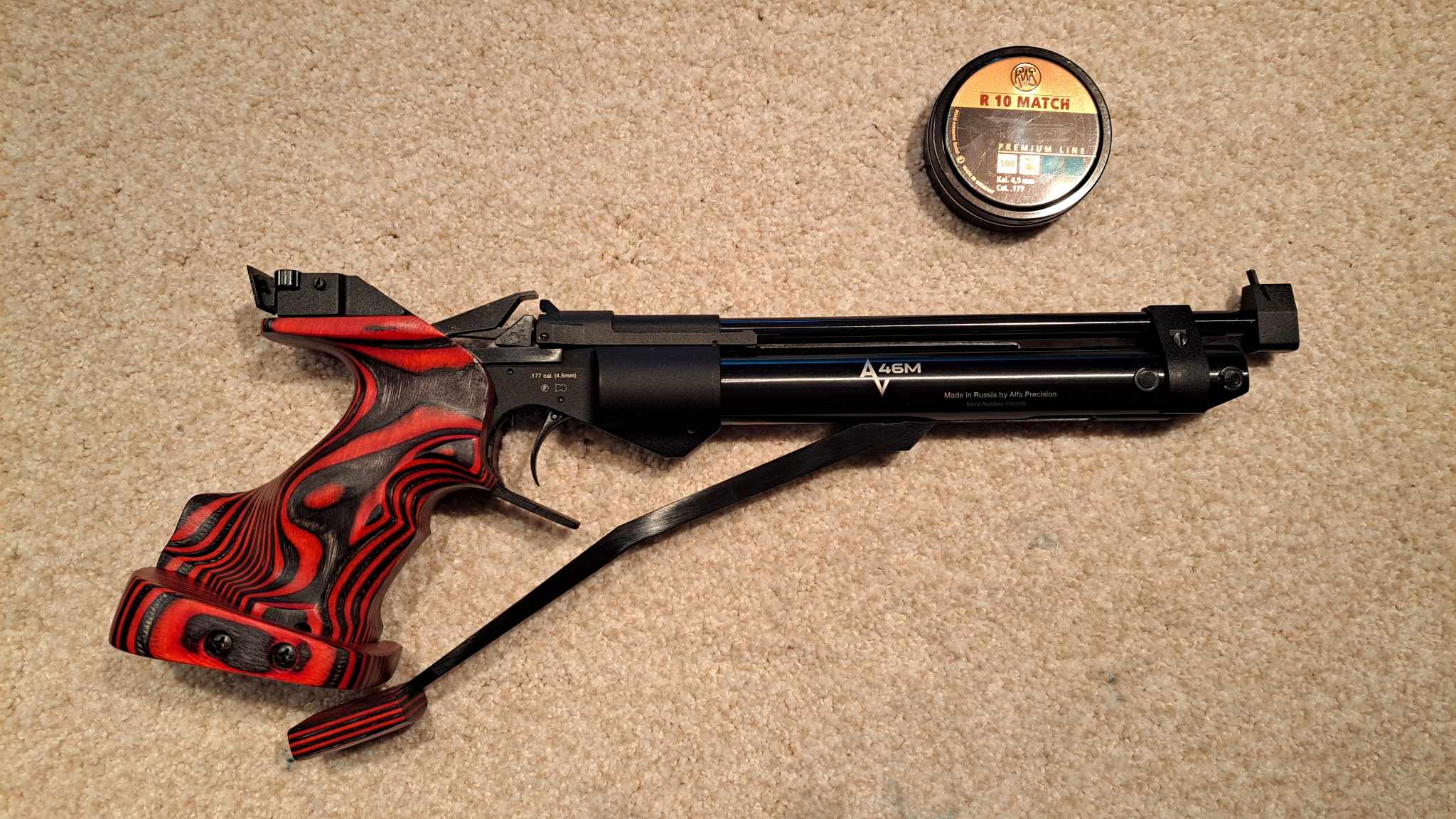

As mentioned in my previous thread I ordered a AV 46M to help get me back into the sport. It arrived yesterday and I took the first 10 shots from it. I'm at 415 fps with 7.0 gr Meisterkugeln. I've read & seen photos on how to adjust the piston TDC. I'll do this myself vs sending the pistol back. My question is, is it to early to make this adjustment or will the seal break in and add fps after a few hundred shots or so?

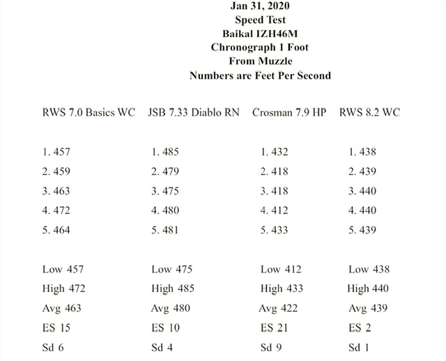

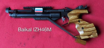

My old IZH46M (about 22,000 shots so far).
Of course the Crosman pellets are VERY tight:
