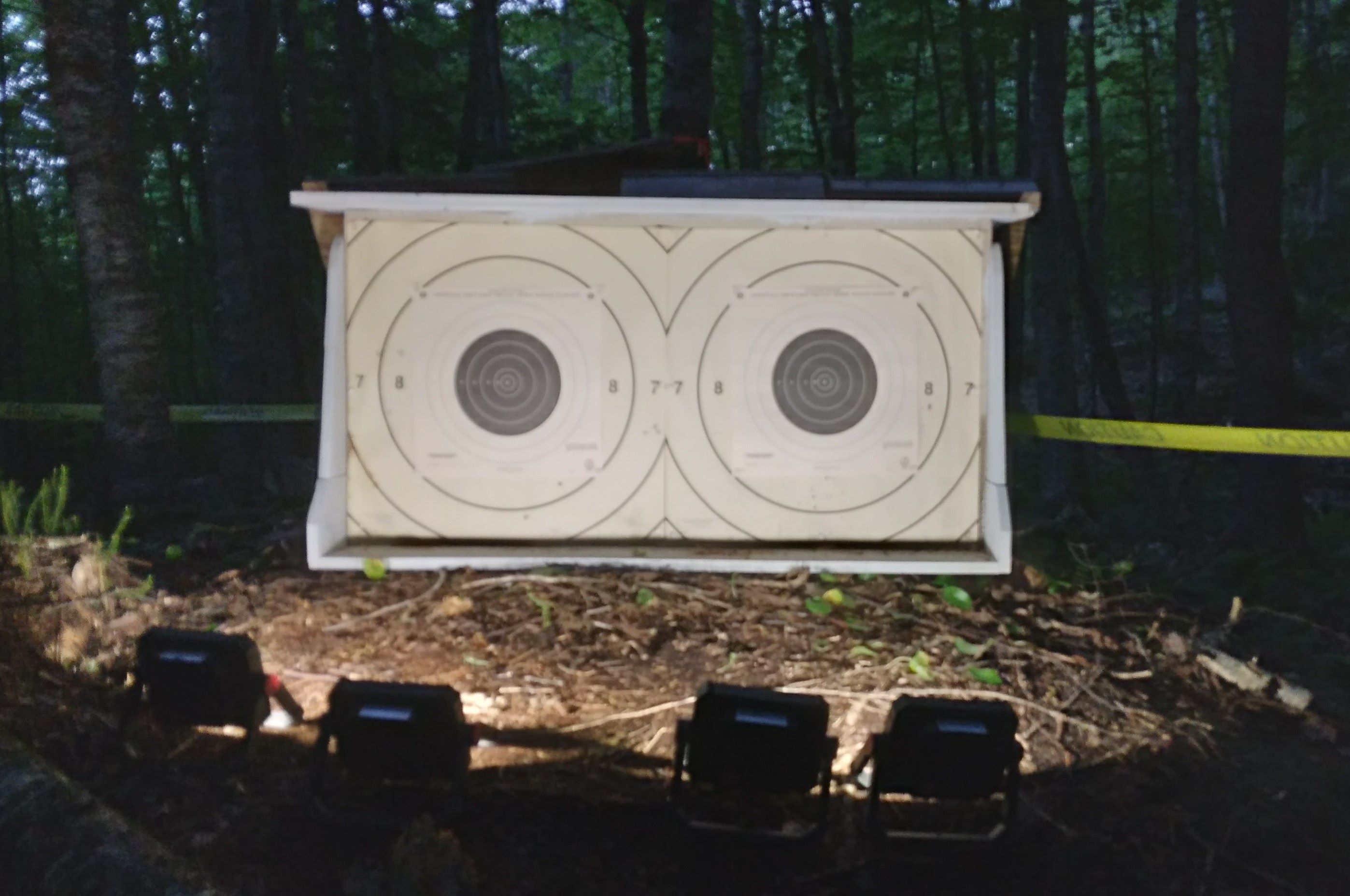

I accidentally discovered Long Distance air rifles. Got an FX Crown and am doing 50 yard, 100 yard, with future 200 yard in the works.
Having had lots of experience with 10 m Air Standing, this 100 yard proves to be very challenging, using a 22 caliber 700 mm/ 28 inch barrel, 25.4 grain slug at 850 feet per second.
Have added weights for total equaling 12 pounds. Having thoughts of trying this with iron/ aperture sights.
Barrel time is the same as FWB 800x 16 inch barrel at 540 fps. Am doing 18 per target because that is what the magazine holds.
