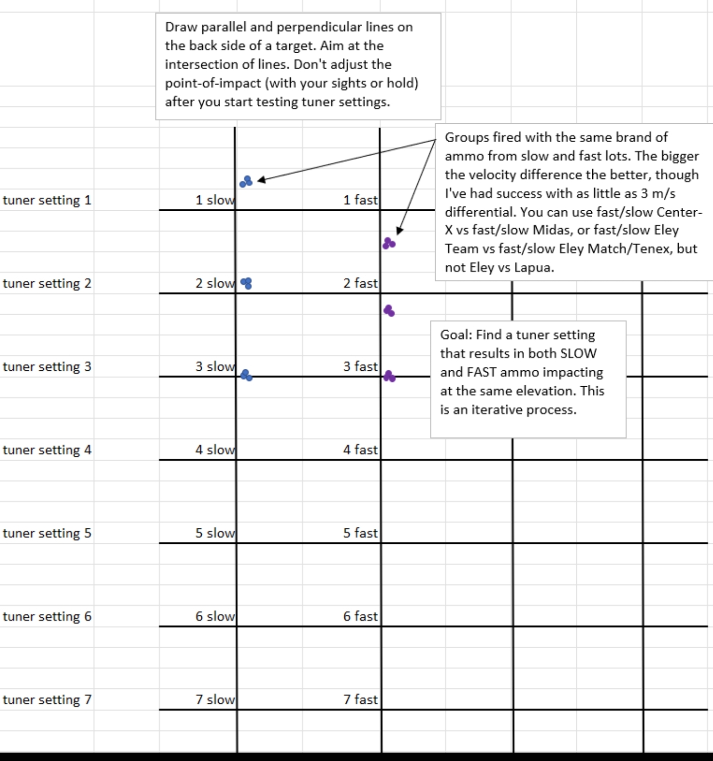

Here's a graphic I made showing how I do it.
I normally do it at 50yd or 50m instead of 100yd. Doing it at 50 tends to go a bit easier because there isn't as much group size variability. In my experience, the 50y positive compensation tune setting gives good results at 100yds.
