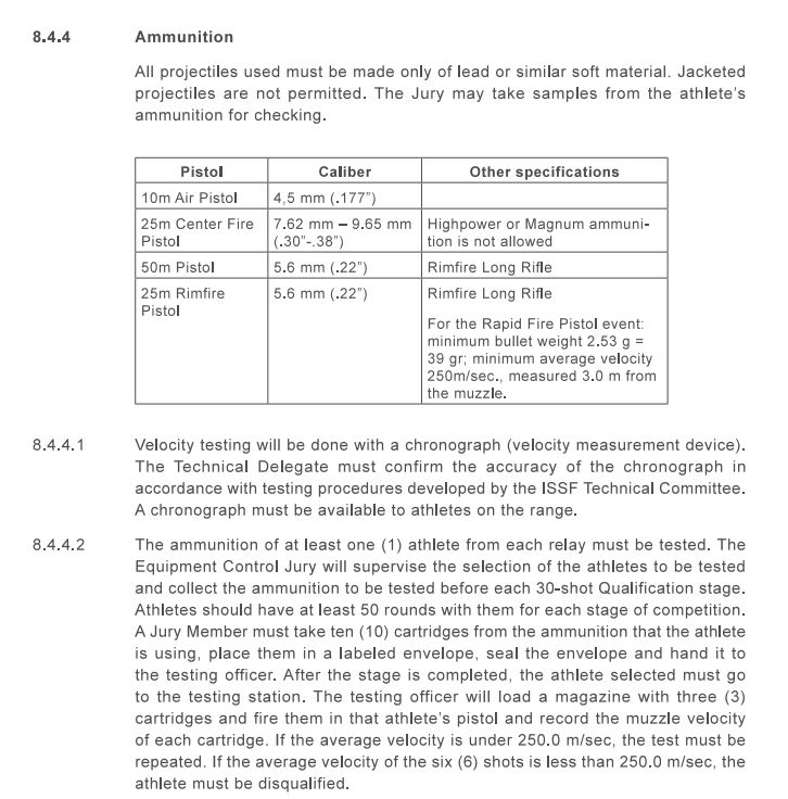

Does anyone know what ISSF rule 8.4.4 really means?
25m Center Fire
Pistol
7.62 mm – 9.65 mm
(.30”-.38”)
Highpower or Magnum ammunition
is not allowed
From my perspective:
9mm is a high power cartridge
It operates at magnum pressures or pretty close so really its a magnum cartridge.
Has anyone seen anything definitive on this?

Posts: 1231
Re: ISSF Ammunition Rules
This is what is written regarding ammunition:
JamesH wrote: Mon Mar 06, 2023 5:49 am I'd dearly love to be able to exclude the morons who shoot 9mm and and think 150/600 is a terrific centrefire score.
If you want to use the ISSF rule book to do that, I would go with the jacketed bullets.
Hope this helps
