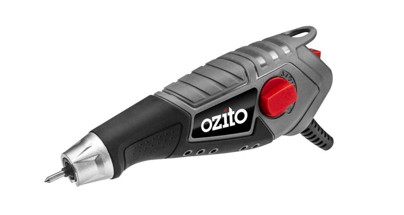

BobGee
Posts: 583
Re: Roughen up quickwood on grips
Post by BobGee »
I use a cheap engraving tool from our local hardware superstore. Has a variable speed of vibration. Doesn’t chip the quickwood.
https://www.bunnings.com.au/ozito-15w-e ... r_p6290600
