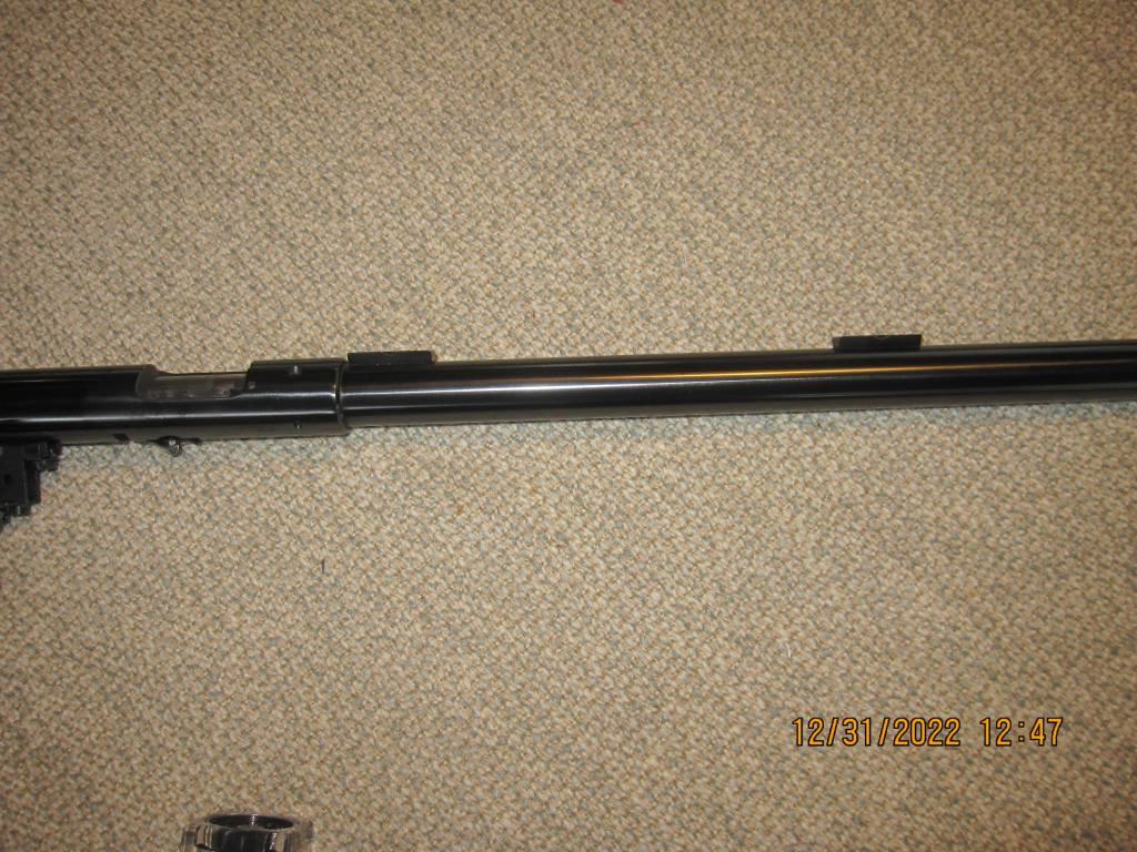

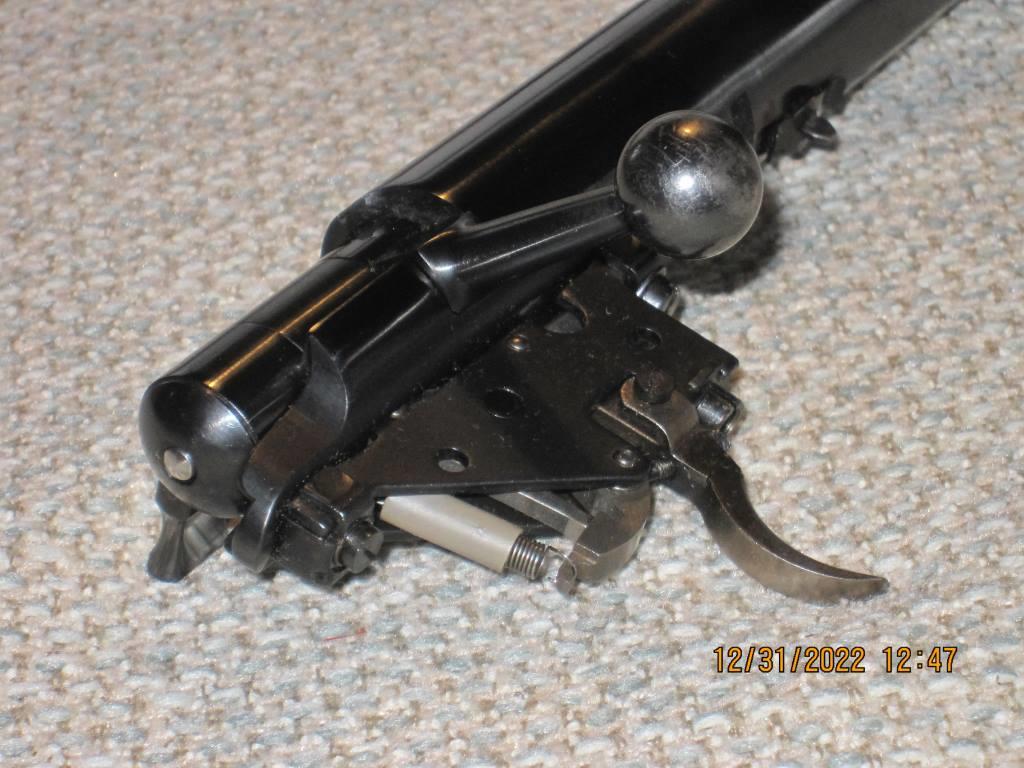

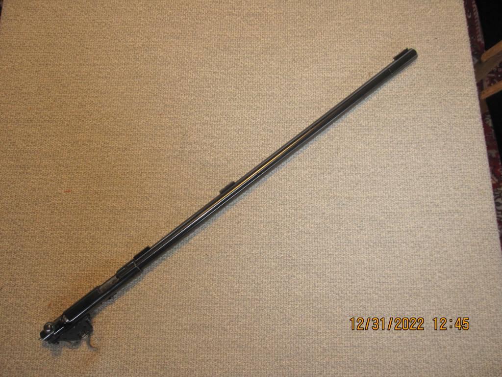

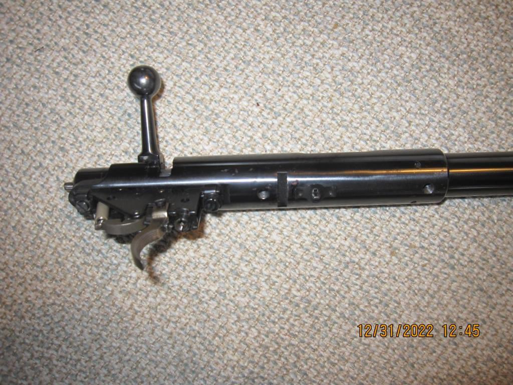

I have an Anschutz barreled action marked Match 54 and 2 extractors on the bolt. Aside from the Anschutz name and address there are no further markings. Can someone help me identify the year and model number? Thanks, James Storm jamesestormmd@yahoo.com

Barrel diameter is about .948” in front of the receiver, .966 at the muzzle, and .954” at about 6” from the muzzle. On the left side of the barrel near the receiver there are a couple of tiny stamping plus the numerals 74 stamped into the barrel. The bolt handle is straight with an integral spherical knob. The rear of the bolt is a flattened dome. The bolt has 2 extractors. The last 3 numbers of the S/N of the receiver are stamped onto the face of the bolt and they match. There is a wing-like safety lever on the left side of the bolt. The top of the receiver is grooved. There are 3 dove tail sight mounts on the barrel, one at the muzzle and two further back toward the receiver. The last 3 ½ inches of the barrel are slightly elevated above the level of the rest of the barrel, but this area does not have any integral grooves. I took some photos but am having trouble attaching them at the moment.

You have a 1974 vintage heavy barrel. I presume the barrel is a tad over 27in? Depending on the original stock it could have been a 1413, 1411, or 1410.

The barrel is 27 1/4 inches long, bolt face to muzzle. I forgot to include that number earlier. Jim

Definitely a heavy barrel. It has one of the single stage triggers, most likely the 1408-U1 set for 500gr.
You asked about the 74 in the proofmarks representing the year of manufacture. Practically, yes this does show that. Technically it gives the date the barrel was proof tested at the Ulm Proof House; not by Anschutz themselves. But that's not likely to have been very long after manufacture.
The bolt handle has lost some of the bluing. This is a normal effect of working the bolt, although the location of the wear makes me think a previous owner habitually rested the rifle on the bolt handle.
