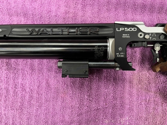

madmax wrote: Wed Dec 14, 2022 3:08 pm I shoot a Morini 162EI.
My Scatt mounting block is permanently located on the frame where the cylinder screws into main body.
Like this?
First shot always results in good group. The others just don't follow
