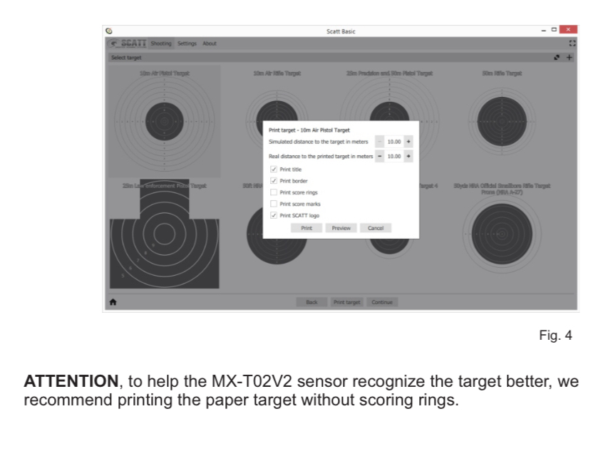

You can print the appropriately sized target directly from your scatt software.
Go to tools, print target, select your discipline and adjust the distance for your range and it will print the resized target.

A tip from Scatt

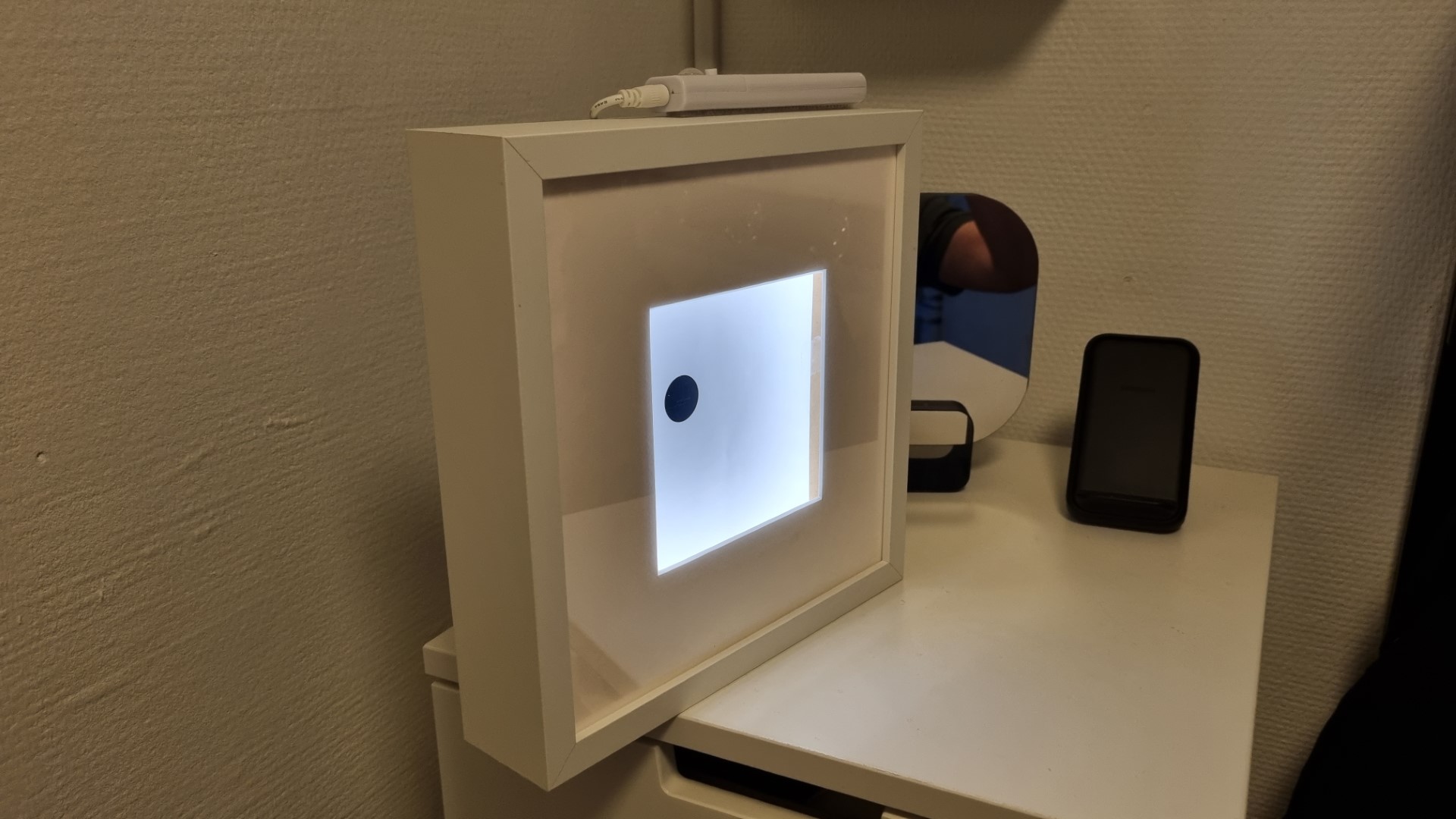

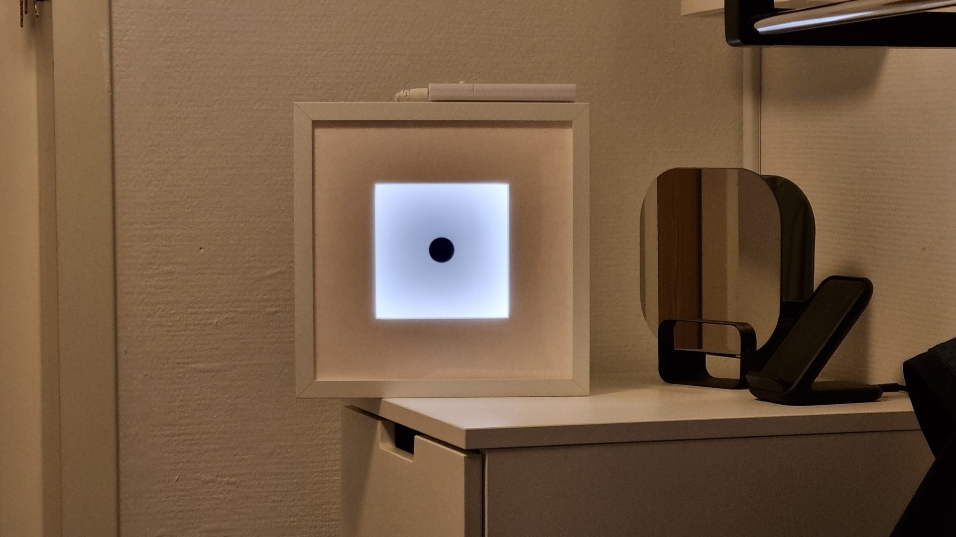

Just bought myself a Scatt Basic and plan to practice both air pistol and small bore 25 and 50m.
I have an illuminated target holder for fairly close range (about 3m), but I have a hard time to figure out how Im supposed to measure the exact distance, is it from target to sensor or from target to shooting line?
I am in the process of putting hinges on the light box so that I can swing it open and change out targets easily

You use the distance from the sensor to the target.

Post by VonKasta »
pfiori wrote: Wed Aug 09, 2023 3:01 pm You use the distance from the sensor to the target.
Thank you for the information, that was my guess as it seems logical but I got thrown off as I felt as if the target size was more correct if I placed myself at the printed distance. Must be my mind playing tricks on me.
