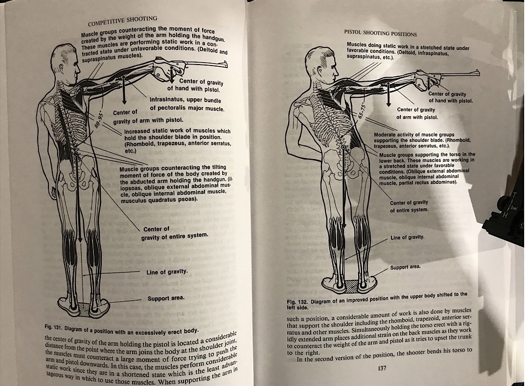

As a somewhat tall person, I think I understand what you are saying (6'4" tall the day I signed up for the Marine Corps. People do shrink some as they get older, though. I have.)toddinjax wrote: ↑Tue May 17, 2022 5:18 pm I have come to realize that some of the inconsistencies in my results comes from variations in my sighting process. I am a bit over 6"1". If I hold my pistol level while at "eye level" I get a great view of the aligned front-rear sights, but I'm well about my aiming area. So I have two options; I can adjust my grip/wrist angle so that the barrel is pointing downward (rear plate still in line with my eye) or I have to lower my arm down until my sights align in the white holding area, which means I end up "looking down upon" the sight picture rather than my eye lined up. I'm assuming the former option would be he preferred technique? Just playing around with this today and got some pretty nice groups but hitting quite low (4cm) so I'm looking for some feedback and wisdom. Thanks for any info.
The issue from your point of view (no pun intended) is that your natural point of aim is above the target, and, you feel you are pointing the pistol down to see the target. The fact is, you probably are. It does not matter. You have the same sight picture at ten meters that a 5'5" person does. (But they may be aiming up, to see the target.) You each have a different center of gravity, though, based on position. The fact is each shooter should have adjusted their sights (and body) to compensate for these differences, and allow for center 10, shots, if everything else is okay.
Check out Yur Yev, on pages 135 to 137,... There is a discussion about pistol shooting positions,..
(Personally, I do not think height differences are that important, as they can be compensated for by sight adjustment, body position, and hold. Also, all questions when one is on a range, are good questions. The questions not asked can lead to injury, and death. (Those of us who have witnessed people being shot, at a range, will understand this immediately.))
from Competitive Shooting, by Yur Yev. pages 135 to 137. (c) 1985 VH Winston, and Sons.

Thank you 1963. Yup, you get it alright. Yes my concern is having to "point downwards" to the target so much with my wrist, more than seems/feels natural as I know hyperflexion can cause injury. If one keeps their head level, not tilted up or down, when you lower the arm you are then looking down at your sights.
I'll have to pick up a copy of that book.
Thanks so much.
