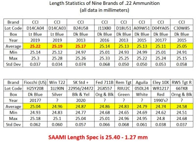

CCI has always tended to run longer than other brands, and the suspicion was that the new lots were overly long. I embarked on a measurement campaign and checked the length of 50 rounds each of all the lots of CCI we have at the college, and various lots I had at home. I also measured eight other brands, although Fiocchi of America is apparently made on CCI production lines, but to different specs.
The results are here:
The two new lots of CCI (D14CA04 & D14CA03) we got last year are longer than ANY other .22 ammunition, although an old lot of CCI I have came close. The average dark blue box CCI is significantly shorter. The Sporting Arms and Ammunition Manufacturers' Institute​ spec for the length of .22 long rifle ammo is 25.40 mm - 1.27 mm ( 1.000" - 0.050"), which is a huge range. All the ammo I measured is "in spec", but quite a few of the new CCI rounds are within 0.005" of the maximum. One thing that is odd is that the standard deviations of the length of the two lots of long CCI are actually better than ANY other ammo, including Eley Tenex & RWS Target Rifle. ​If they'd just make the stuff shorter, it could shoot really well. The Fiocchi of America ammo is shorter than all the lots of CCI I measured, but not by much.
I had a student test fire 20 rounds of CCI in his Benelli that was all 24.20 mm or longer. He had several feed jams. When he switched to ammo that was between 24.00 mm & 24.10 mm, the feed jams went away.
We have most of a case of dark blue box Lot #C30W85 left, and we've used that for recent matches. That lot turns out to be the shortest CCI I've measured. My plan was to send the students off to the National Championship next week with that. HOWEVER, at practice on Friday, we had several problems with bolts not closing all the way, causing light hits. It turns out a lot of the rounds in this lot are caked with excess wax. I took the remains of one box home, and this is what I found:

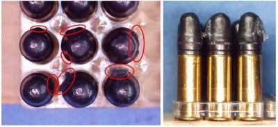

I have contacted CCI to see if the two super long lots we received are unusual, or represent an intentional design/manufacturing change. I've seen the wax problem in the past, but it's usually pretty rare, and the two long lots are fine in that regard. Now that ammo availability & prices are improving, I will be investigating other options. We used to have RWS Target Rifle for fussy pistols, but that has been discontinued by the US importer. We have quite a few pistols that will shoot Aguila well, and we have plenty on hand. I just need to work on getting all the other pistols to work with it. I know I can get the Pardinis to work if I cut the recoils springs down.

I've seen that glue booger on a box of recent CCI as well, and have taken to checking the rounds pretty carefully. It's sticky, but seems to pop right off if you get a fingernail under it. I'd hate to shoot it into my barrel! I've only seen it on one box, other boxes in the same brick have been clean (so far).

I heard back from CCI. Their response was pretty much what I expected:
A) The ammo is in spec, because it's shorter than the SAAMI maximum.
B) They have not changed their manufacturing process intentionally to produce this overly long ammo. Whether future lots exhibit the same issue is at the mercy of manufacturing variations.
The tech support guy I communicated with was going to send the manufacturing folks my full table of measurement results. It clearly shows how out of line CCI's ammo is compared to everyone else's ammo. At some point, I think I will examine a few rounds of the longest & shortest CCI stuff, and see if the issue is the bullets or the cases. Changing the casting for the bullets would be expensive, but I suspect the cases are all trimmed, and it could just a matter of adjusting the trim length a small amount.
