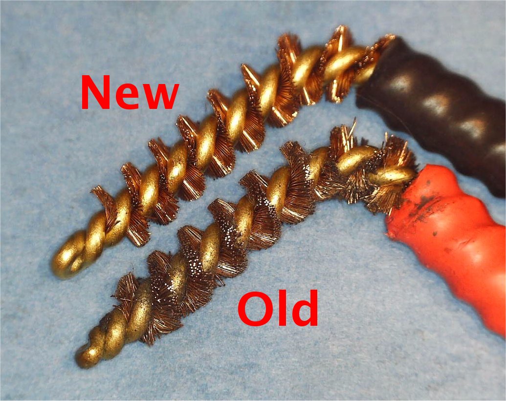

Over the last decade, I've probably made over 100 of these for myself, friends, and the college team I help coach. I've lost count of the number of times I've rescued somebody mid-match with a quick chamber cleaning. They do wear out over time, and need to be replaced.
Lately, I've noticed that they seem to be wearing out much faster than before. The team seems to go though them in less than a year. I took a look at the latest bag of brushes from Brownells, and compared it to one of my personal brushes that I've probably had for close to a decade. They've changed the design, and they have WAY fewer bristles in the spiral than they used to:
I submitted a highly unfavorable review at Brownells, and I am now on the lookout for a good replacement. It's hard to tell from on-line images, but a lot of the options don't look much better. I'm going to purchase a variety of brushes, and will report back once I've identified a good replacement.
In the meantime, if somebody knows a good brand of bore brushes with lots of bristles, let me know. Alternatively, if you know of a brand that is particularly short on bristles, that will save me wasting time & money getting samples. I'm currently looking at ordering: Sinclair, Pro-Shot, Bore Tech, Dewey, Hoppes, Boosteady and Tipton. Some brands of brushes only come in the most common calibers (like .22 & .30), and they don't have .25 caliber (or 6mm, which should also work well).

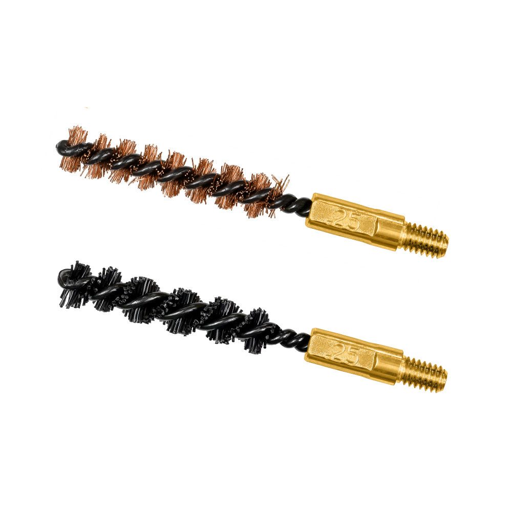

Take a look at the Otis line…their bore brushes last a long time and we use them hard.
https://otistec.com/6mm-243cal-bore-bru ... -1-bronze/
Posts: 3287
Re: .22 Chamber Brush Problem
Thanks! They look pretty bristly, but they only come in shorter "pistol" length. That will make them a bit harder to bend for a good handle, but I can give them a try. The longer "rifle" ones give you a good long handle to reach into Pardini SP's ejection port without dismantling anything.

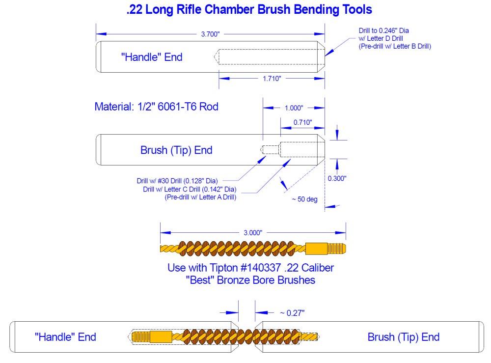

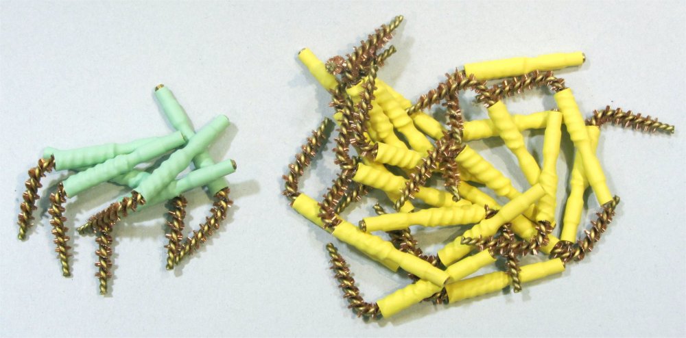

I spent some time over the Holidays making up a large batch of chamber brushes. It turns out MidwayUSA has a fairly good price on the Tipton .22 caliber bronze brushes ($6.99 for a 3-pack). They run free shipping promotions fairly often, and I bought 10 packs several weeks ago.
When I first started making these, I designed & machined a pair of bending tools for the .25 caliber Brownells brushes I used to use. I made a new set redesigned to work with the Tipton brushes:
For an individual who isn't making tons of these, I suspect a couple pieces of 1/4" ID pipe would work fine.
I've found it useful to have two styles. One version is bent at 90 degrees for cleaning barrels when a pistol is disassembled, or for Benelli MP90/95's on the firing line. The other is bent at about 75 degrees, which allows cleaning the chamber of Pardini SP's on the firing line.

Posts: 3287
I used to code them by date using different colors, but that turned out to be a waste of time. Some get used a lot, and some hardly ever, so age has nothing to do with what condition they are in.
