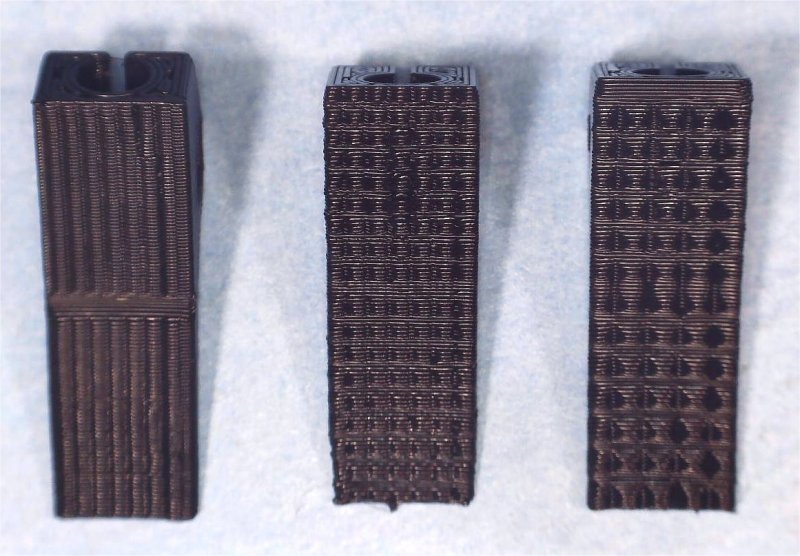

I can design & print pretty much anything I can imagine. The hard part is finding the time to do the CAD design and fit it into the steady stream of print jobs. The resolution of the printer does introduce some limitations to fine details, like how sharp I can make the checkering on the trigger faces. Here are the three triggers I made yesterday:
The layers from the printing process make them a bit hard to see, but the two on the right have pyramids of different sizes on the front.

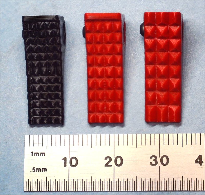

Here are the two "sensive" designs:

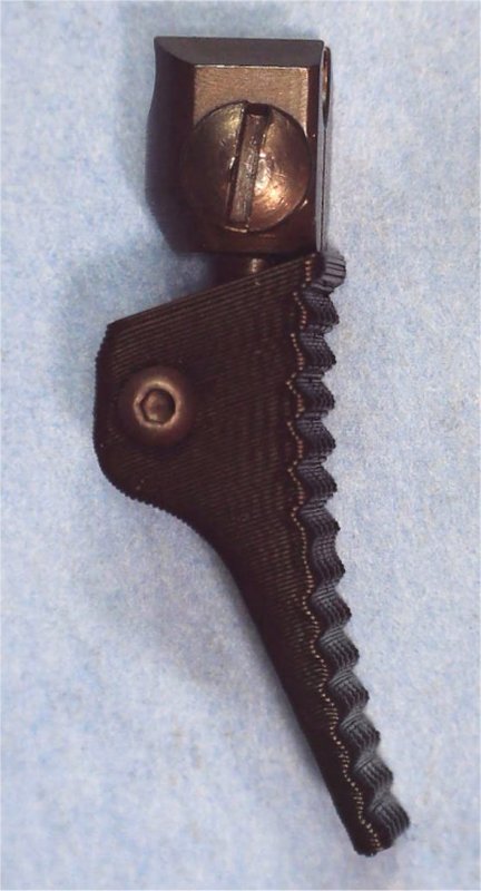

And here is the one I'm going to test for a bit, with the mounting hardware:
I can definitely feel the bumps. Whether that translates into better trigger control remains to be seen.

That's basically a copy of the MatchGun MG2 Trigger modified to fit the Steyr mount. It has the same grooved structure as the factory Steyr trigger, but it's a bit narrower. The grooves are small & smooth enough that is has no textural feel at all to my battered trigger finger.
I can make the CAD files available at some point, but I have WAY too many projects on deck to mess with commercializing this stuff.
I tried the coarsest one for 10 shots, and I think it will help, but it's no miracle cure. The checkering isn't as sharp as I'd like, and I think a slightly coarser pattern may be better. I may have to sharpen the checkering with files to get the full effect. I printed a coarser one last night, but haven't had a chance to try it.
