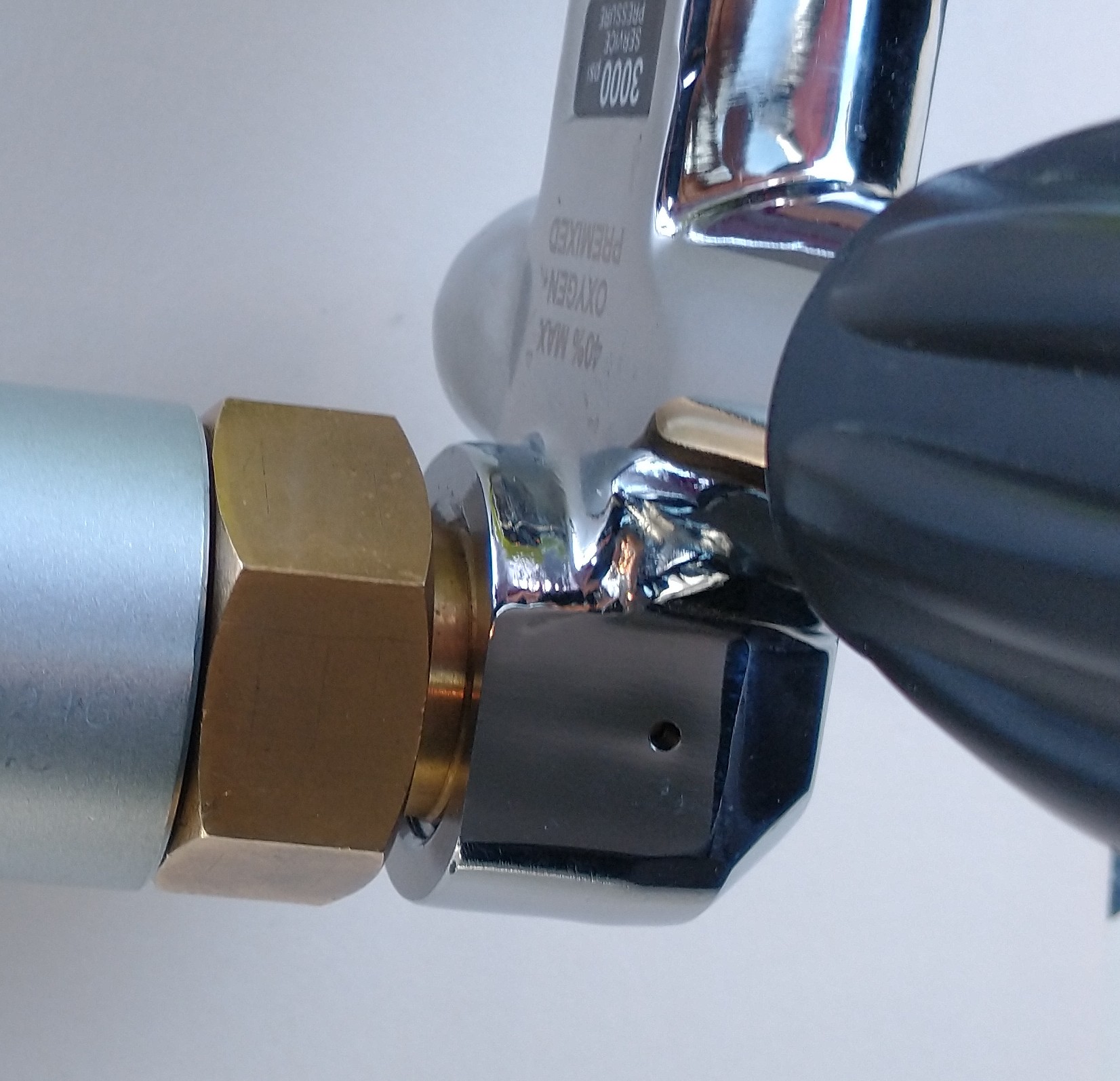

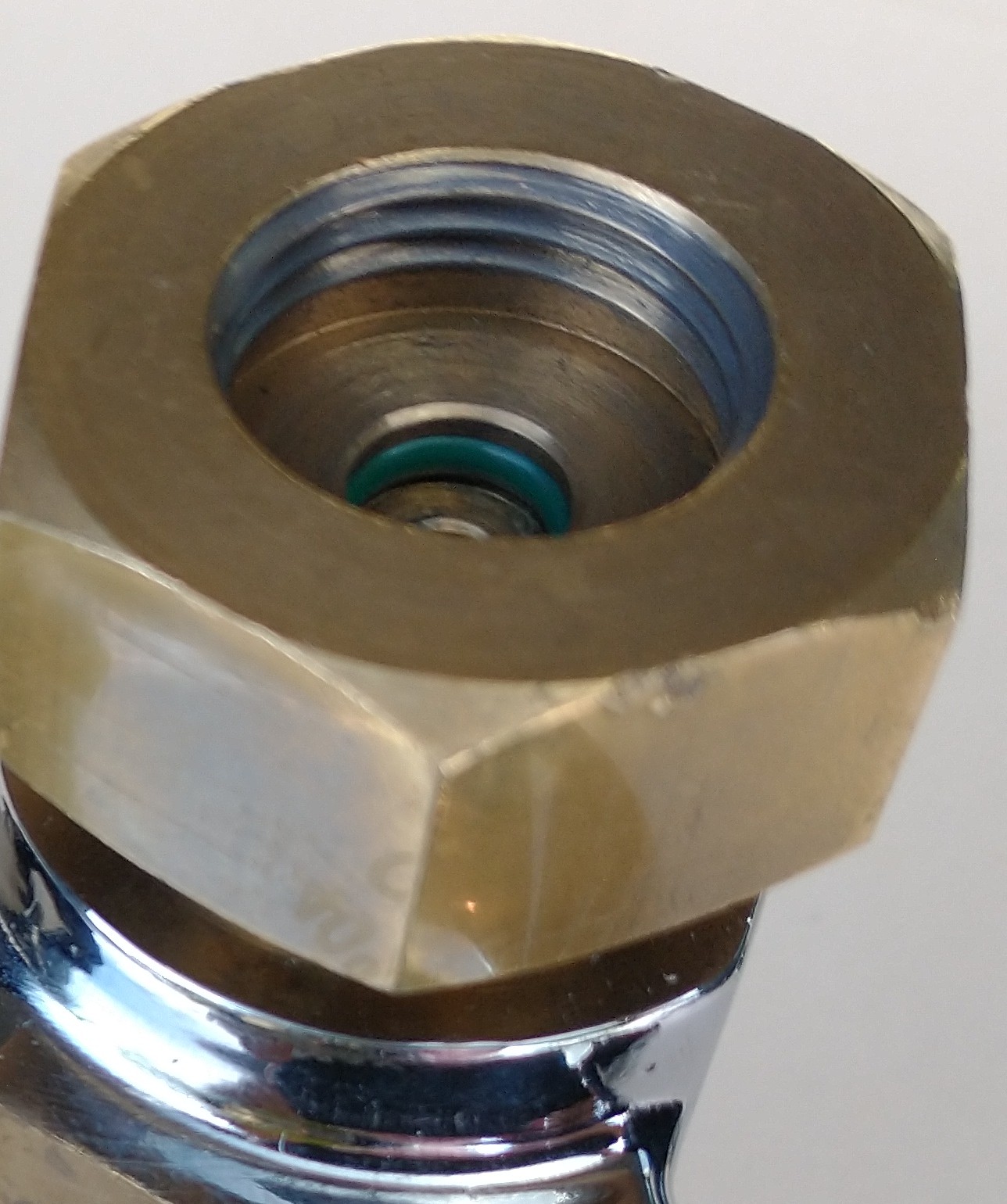

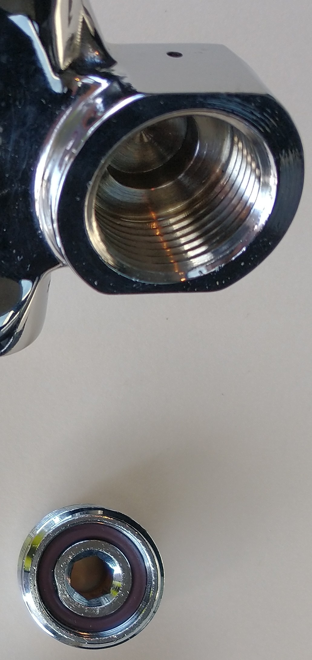

Take an allen wrench. Remove the yoke insert. Thread the FWB fill adapter directly into the tank threads just like those German Gun Designers intended it to work and move on.... If you have trouble reading these simple instructions, look at the pictures I attached. Your welcome, I saved you all the time and effort buying useless adapters because I actually did it, and have done it for years because I actually have a P44, and some of us here can't seem to understand how easy it is.......
The used tank I bought didn't have a convenient convertible valve that had a yoke insert. Mine looked like this:
https://www.scottsscuba.com/product/xs- ... alve-/1011
My local dive shop then tried setting me up with a convertible valve but the one he initially used converted the yoke to a 300bar fitting which, of course wouldn't seal with the 200 bar fitting supplied with my LP10. So he dug deeper into his supplies and found me one that did convert to the 200 bar fitting. So it can be complicated if you don't buy a tank with a convertible valve and it can still be complicated if do have a tank with a convertible valve as it might convert to a 300 bar fitting instead of the 200 bar fitting you need.

Im sorry it was so hard for you. Perhaps you got the wrong stuff because you just didnt ask the right questions. It went quite easily for me when I took the FWB adapter to the dive shop with me, and asked for a 200 Bar tank that accepted it. Easy Peasy. Again, because you got it wrong, please stop overcomplicating things and telling people irrelevant stuff. New guys need the straight poop. We owe it to new guys to tell them the facts, not launch them down bunny trails. Remember, EVERYTHING YOU NEED TO GO FROM THE TANK TO THE GUN IS IN THE BOX. Buy the right tank and the world is a simple place.
