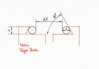

Does anybody who has modeled the Morini trigger or measured it accurately know the dovetail dimensions for the trigger?
Thanks.

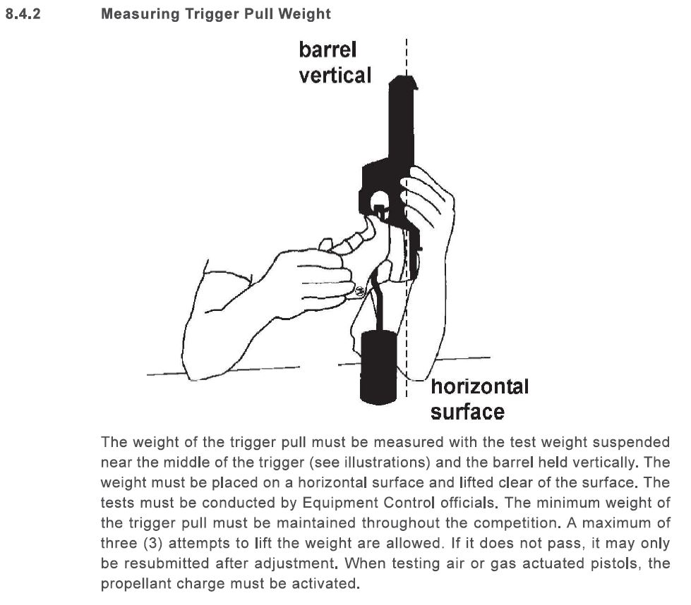

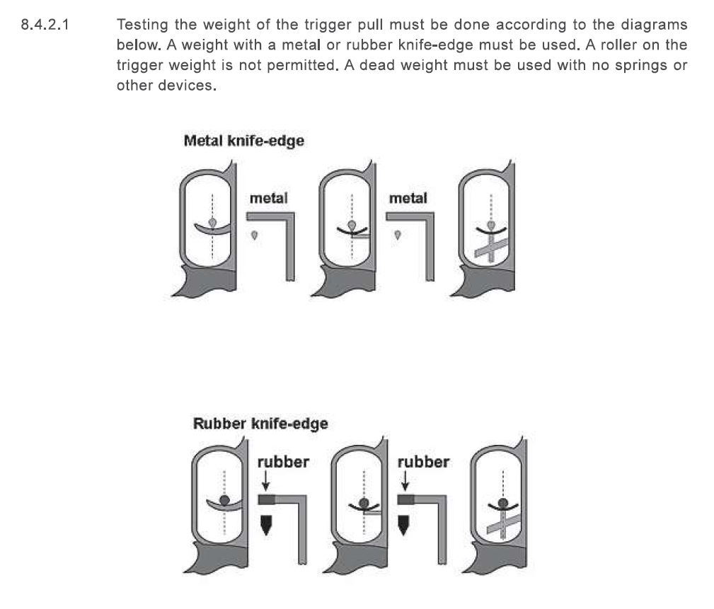

Has anybody failed an equipment check with one of these?
If you check the trigger weight using the notch in the trigger
BUT use it by pulling the trigger at a point below the notch, You have a
below minimum trigger weight. I see pictures at matches and wonder
who will be the first to protest it. It would make an interesting discussion....

aalbert wrote: Tue Jun 22, 2021 10:05 pm Does anybody who has modeled the Morini trigger or measured it accurately know the dovetail dimensions for the trigger?
Thanks.
Yes.
Posts: 1231
Re: Morini Trigger Blade Options - CM 200 EL
spektr wrote: Wed Jun 23, 2021 12:07 am Has anybody failed an equipment check with one of these?
The trigger weight should be measured near the middle of the trigger.
If there is a notch in any other part of the trigger, that is irrelevant...
Those kinds of protests end very quickly when the person protesting is shown the rule book... ;)
aalbert
Posts: 163
Location: Miami, FL
Post by aalbert »
Thank you for sharing. Cheers.
