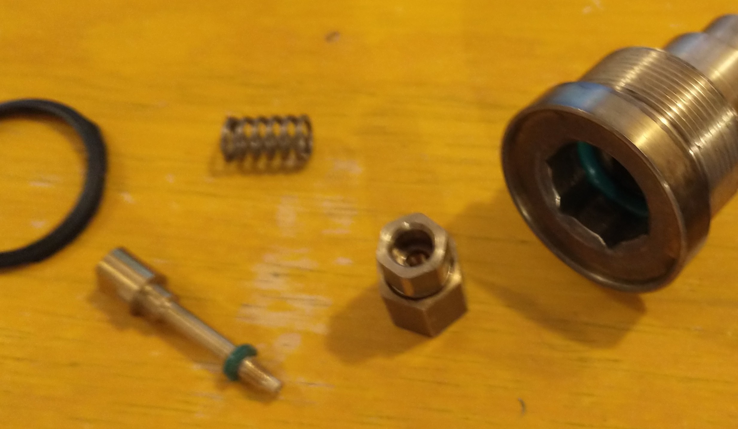

Update:
I was able to remove the valve assembly using the 14mm wrench. Not sure what to do next.
I have a feeling that the wrench was supposed to remove the inner part of the valve rather than the whole valve.
Note: This tank was not a slow leaker. It was a catastrophic failure. The tank was just sitting on a table and all of a sudden, it released all of its CO2. Very impressive.
![Image](http://artzen2.com/webmisc/qh012432_lzn.jpg)

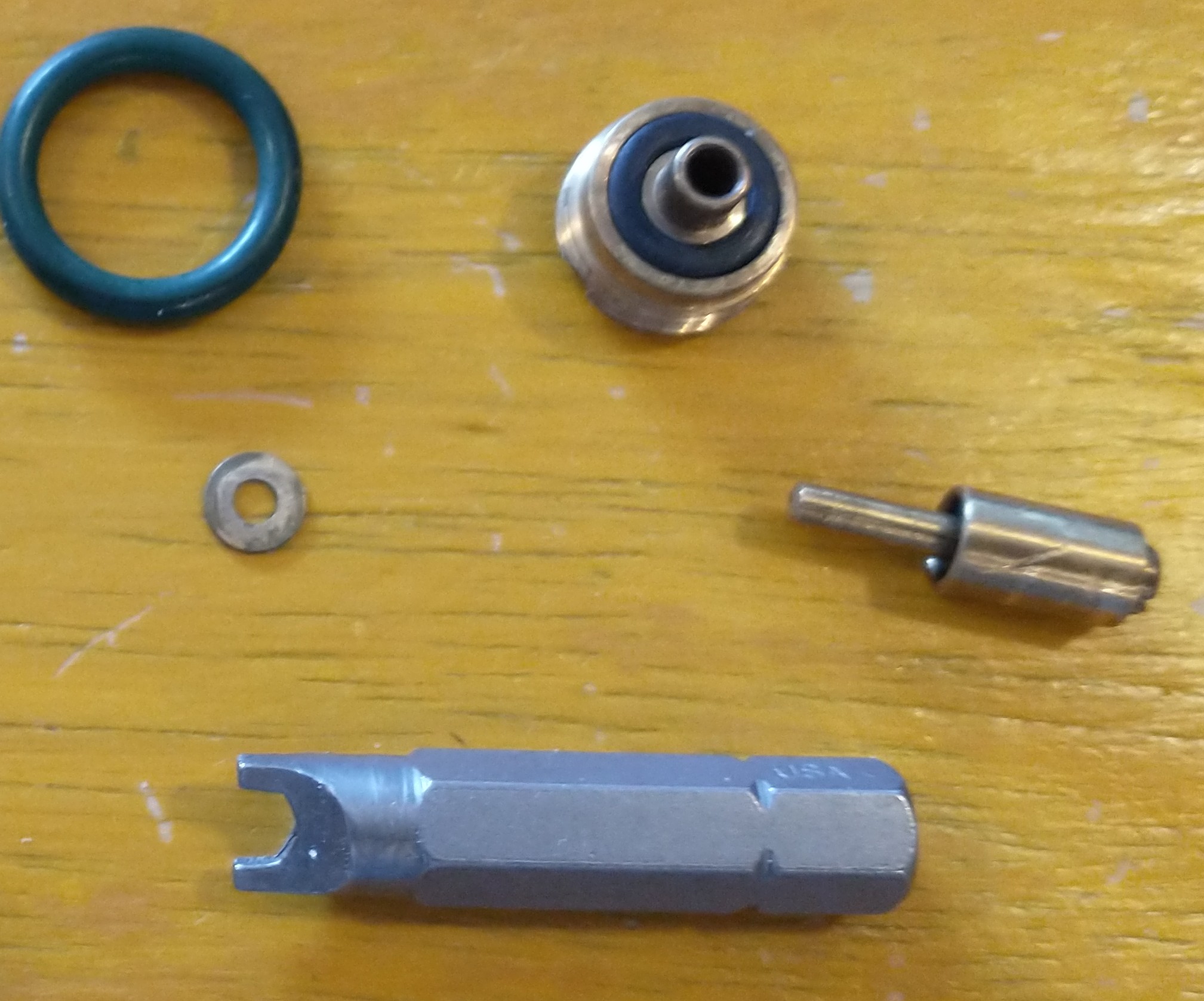

Re: I need a CO2 tank for a CPM-1
That CP2 sketch is misleading, you so not remove the 14 mm boss.
Instead, you use a clutch screw driver to engage the smaller threaded valve core..... It looks like this. The screwdriver tip is a special from tacoma screw products, and costs all of 2.49 ish
The o rings are easy, but i need to unscrew the screw that has the flat O ring that seals the tank and I need a flat sided screwdriver and a bit of Kroil..... It comes apart really easily......![Image]()
Ok disassemble the CPM1 valve assembly by holding the rectangular boss with a pair of needle nose pliers. The square machined knob unscrews with finger pressure. It slides out along with the spring. There is a flat bottomed urethane o ring McMaster Carr PN 1170N14 to replace. You might need to dig it out of the machined boss. The trick to changing it is to lube it putting it on the shaft. To compress the spring so you can get the o ring in it's groove, put the shaft and spring in the housing, put the housing on the table with a 1/4 drive socket under it to compress things. Compress the spring, stuff on the o ring into its shaft into position keeping the spring compressed... Screw rhe hex boss into place and you're almost done. Replace the o ring on the outside of the housing where it seals to the tank. The oring is mcmaster pn 1288n12. Lube it with assy lube and tighten it up.
The 14 mm o ring probably needs to be changed also, ill get the number later
Easy peasy
EDIT NOTE....... The PN was typed in incorrectly..... it IS 1170N14, NOT 1170N15 as originally posted.
Sorry

I finally finished repairing my two CPM-1 cylinders. It was an adventure.
I don't think that your number for the McMaster Carr PN 1170n15 is correct. It has an OD of over 6mm and won't fit, even with forcing into the opening on the hex boss. Part number 1170N14 fits beautifully on both the shaft and into the hex boss.
But that wasn't the problem. It was the overpressure relief system in the assembly at the end of the valve. There's a burst disc and a 3mm deep collar that creates a space for the disk to expand and burst. When the disc bursts, the CO2 follows a path that bypasses the O-ring.
The discs had burst on both of my defective cylinders.
![Image](http://artzen2.com/webmisc/qh012677_lzn.jpg)
I finally found some materials to replace the burst disc. I used what I had at hand. Obviously, the overpressure system will no longer work, but I can use the cylinders now. (I promise to stop overfilling the cylinders.)
I'm testing the cylinders by filling them with some CO2 and then leaving each one in a Ziploc bag overnight. If there's a leak, it will be obvious in the morning.
