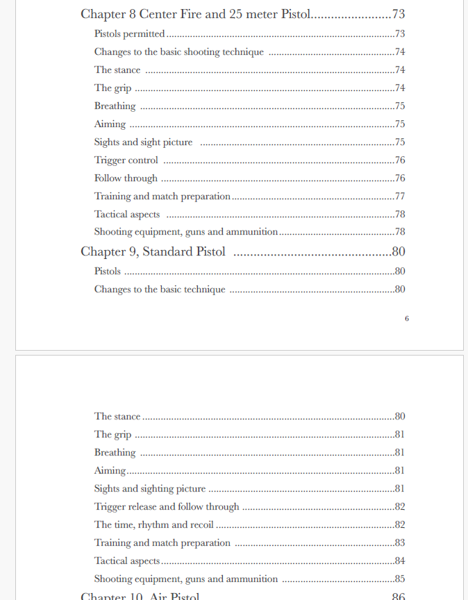

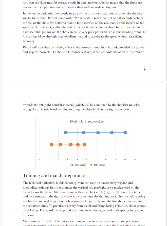

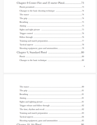

Re: 25m pistol
Also if anyone would like a great resource covering 25m pistol / centre fire and standard pistol as well as the other ISSF disciplines, get hold of "Master Competitive Pistol Shooting" by Ragnar Skanaker. The book has a chapter on each shooting event. well worth a purchase.
